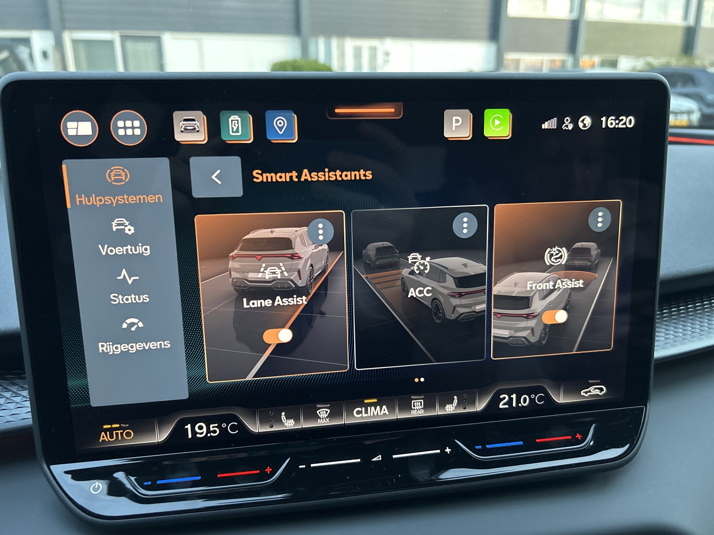

Hmmm,
These are the only settings i got:

Hmmm,
If I'm not mistaken, there should be a Travel Assist item along with what you already have in Smart Assistants.

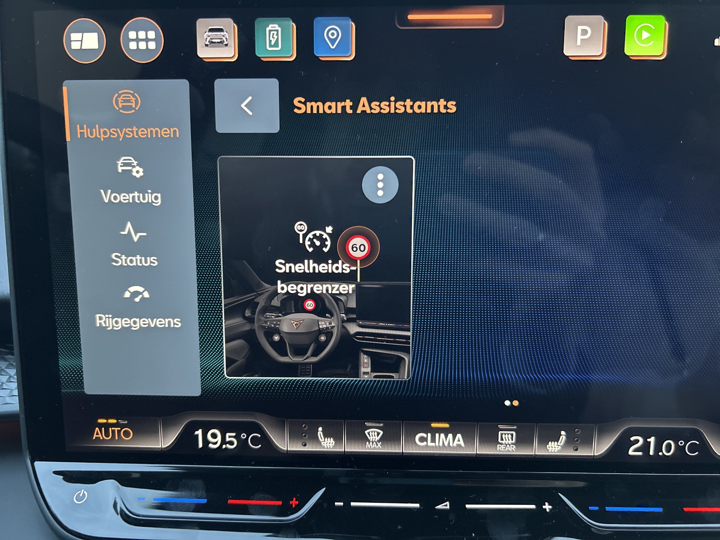

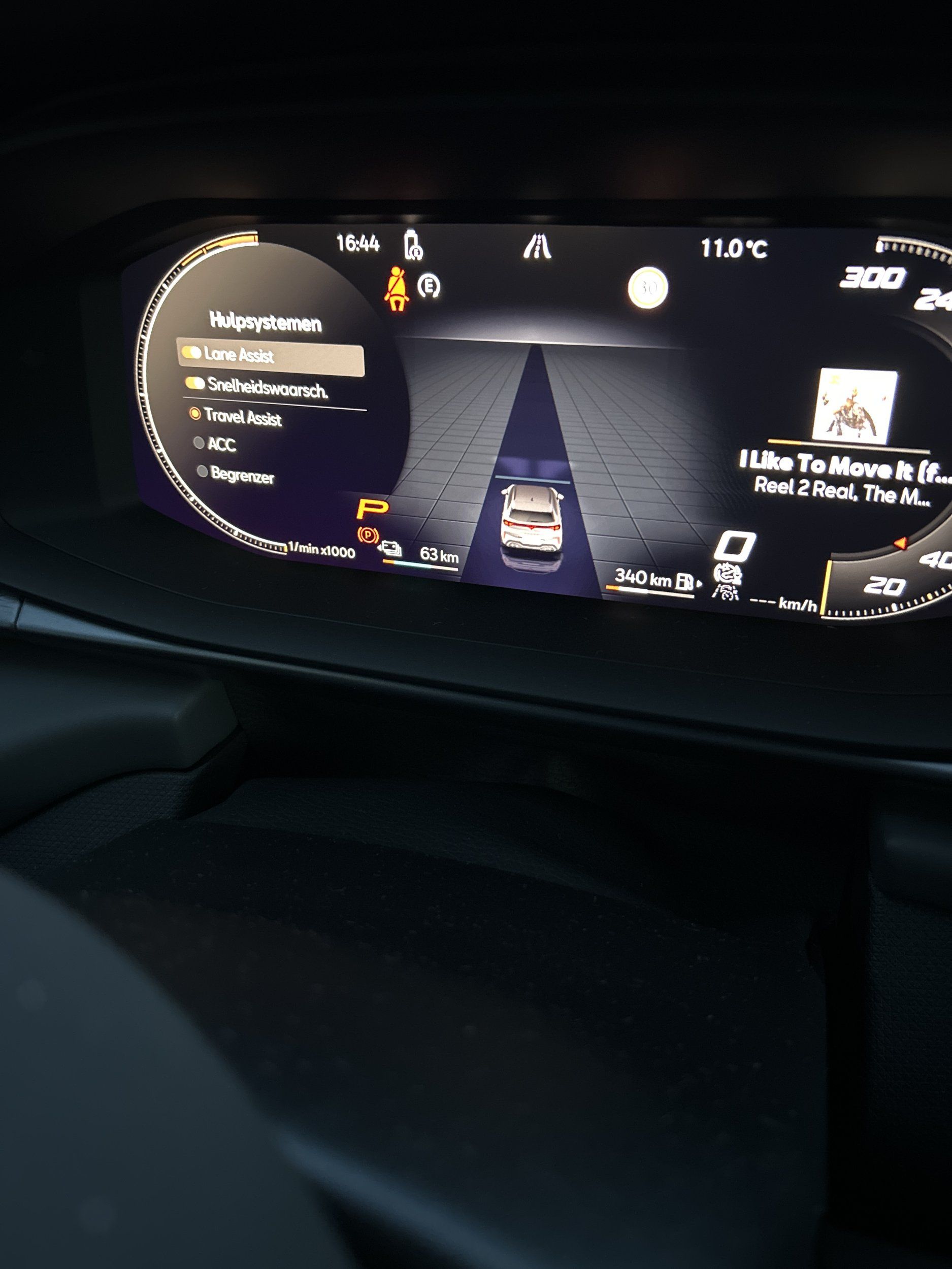

Well, when i touch the button on my steeringweel i see the option… so it is in the car…
But in the multimediasystem i cant see the option…

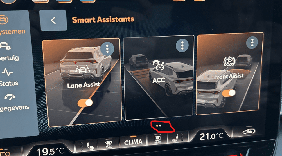

i got exactely the same, on the menu on the tablet the settings are limited to "Lane Assist" and there is nothing related to "Travel Assist" on any other page / menu, but when pressing the button on the steeringwheel i can activate the "Travel Assist" - by default it was selected ACC. I have tested briefly this morning - it keeps the middle of the lane, breaks if you turn on the signal and it detects an intersection ahead, it ask you to keep the hands on the steeringwheel, it turns the car if there is a curve ahead, etc. - i didn't knew this feature. Thanks!!
