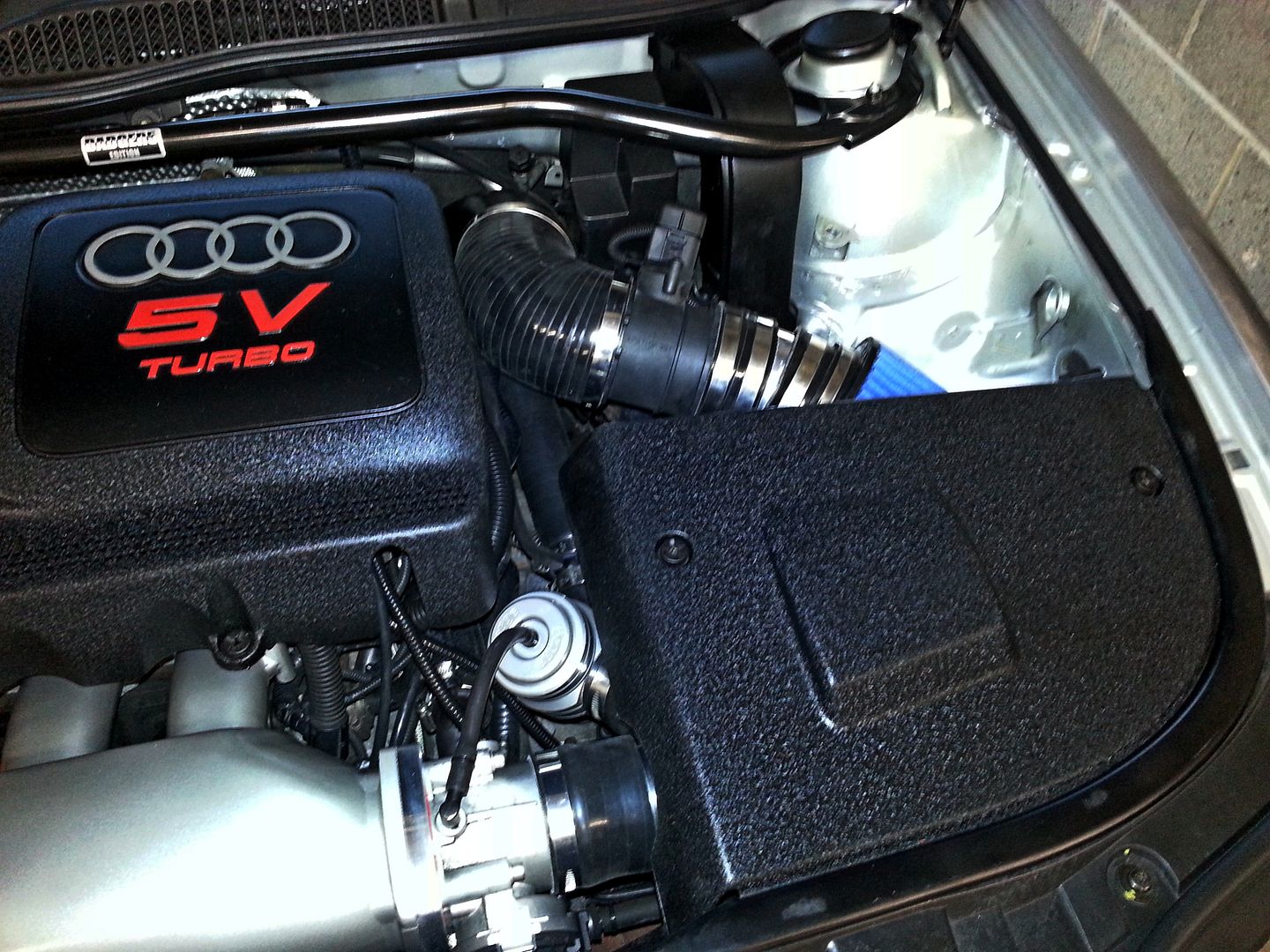

Grabbed a bit of time this afternoon to sort out the pikey bodge to secure the filter... George the super hero to the rescue yet again machining me up a 100mm OD adaptor ring for the MAF tube so I could use 100mm from the MAF to the filter...
...then fab'd up a suitable bend in 100mm alloy to join the filter to the MAF
...after painting it (of course :)) I set about modifying the airbox so the filter would fit...
...modded the cover a little...
...and of course with all the covers fitted...
...and to prove its actually there...
Got a couple of support brackets to make and check some clearances to prevent rubbing etc but thats more or less it bar WMI fitting (test fitted a tank and thats goes in ok)... all I need now is more boosts!!

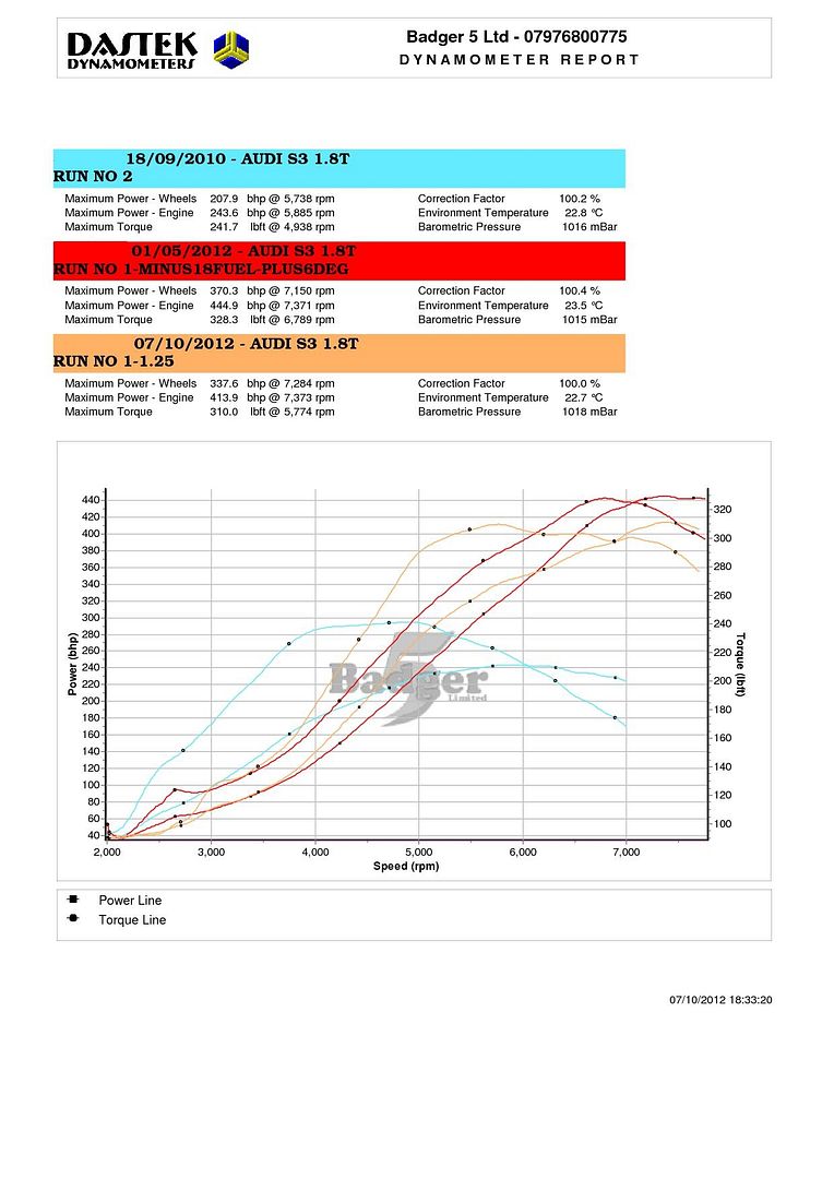

Big thank you to Bill for taking the time to dyno my car today... I pretty much left him to the map changes and stuff today as he has far more experience with it than me so I built engines and kept an eye on stuff letting him work his magic...
Fuelling needed a little fine tuning as he boost levels rose which I expected anyway... however... my car being my car she did put up a fight... this time the Tial wastegate springs... first runs would net higher boost than subsequent ones as the Tial got hot... guess its altering the springs tension when hot and is highlighted more as we are running open loop boost control... ah well... at least it gives me something else to do lol...
Anyhoo... scores on the doors...
A bit more fine tuning to do of course and I need to find a solution to the boost issue... have a few ideas so will see how that goes...

:1st: Well done mate, Bills done you proud. Nice curves. Thats an easy 400 bhp.
What boost are you running. The issue with the boost altering due to the spring temp is tricky.
tufftybloke
Badger 5 Edition
Feb 28, 2009
657
Gloucestershire, UK
26psi... plan will be to stabilise the boost first so it does what its told then will look to taper the boost up a tad at the end... depends on how hot things get and what the EGTs are doing... there is a little more in her yet I reckon so this could end up a bit higher and not running WMI yet :)

As an interesting comparison... the power curves from mine (GT3071, log manifold), Welly's (FP green, tubular race manifold) and a stage 1 S3 (custom code)...

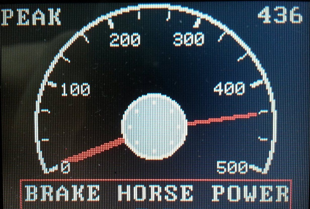

Liquid was showing healthy airflow (assuming I have the scaling right which I believe it is) and tried the 'power gauge' for a giggle..
Whilst I think its a little optimistic its good pub ammo ;P

While I know there is a little more to come power wise with fine tuning, WMI etc I did sort out a power graph showing a completely std S3's power compared to where she is now with a GT3071...

Would you mind sharing your timing, AFR and coil dwell numbers as I must be doing something wrong. Look how much I loose over 6000rpms:
tufftybloke
Badger 5 Edition
Feb 28, 2009
657
Gloucestershire, UK
AFR is 12.5 (0.85) when on boost... timing wise I just added a few degrees at a time through unisettings and logged... if it took it then I added it across the board until pull occurred then pulled it back as required at the rpms the pull occurred..
tbh... your graph looks flow/boost related... would need to see plots of boost and logs of airflow...

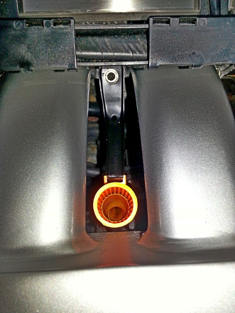

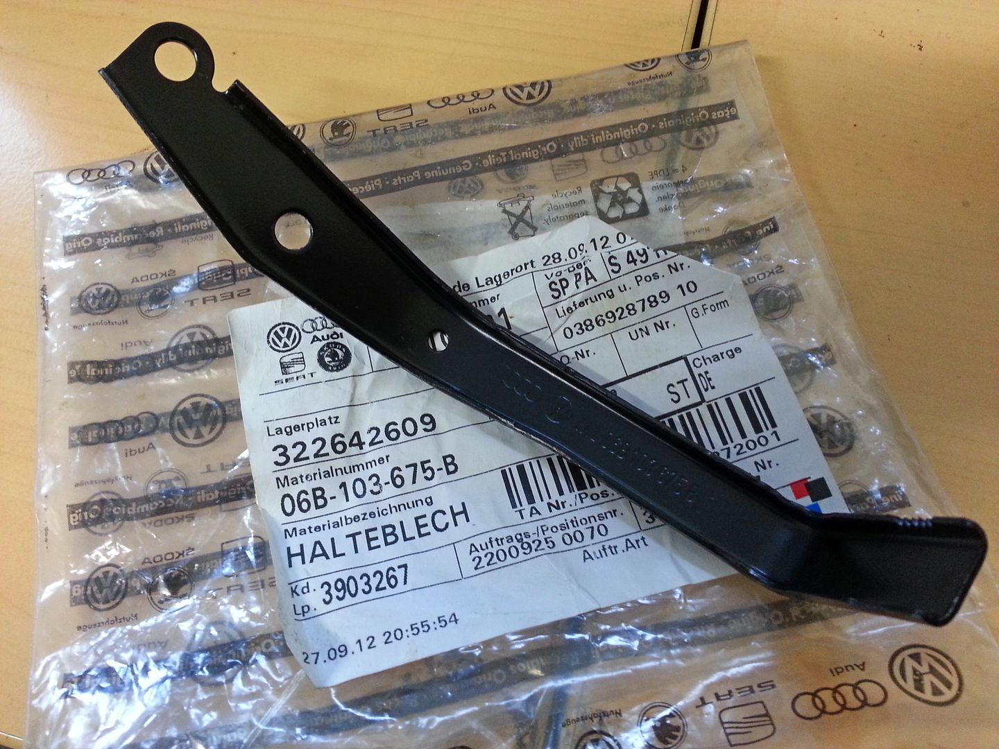

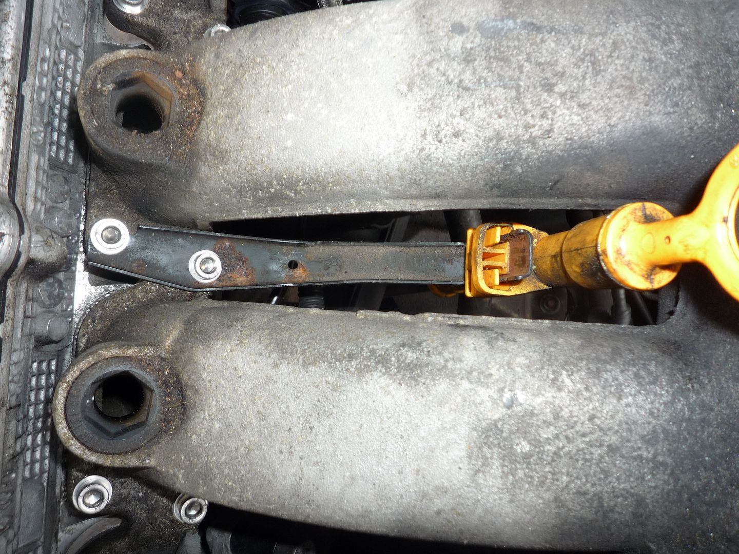

Minor update... got a little pressie from great mate Mark at ADI... dipstick tube bracket for an AEB A4... doesn't sound like much but its ideal for my inlet manifold..
This fits to the centre fixing bolts of the inlet manifold and holds the dipstick tube between runners 2 and 3... had to mod it a little to fit right as my runners are a little shorter due to the fabrication but bit of paint and all sorted...
Here it is on an AEB...
...and on mine...
Car is driving nicely but map still in need of tweaking as its got more to give and I want to smooth off some of the little rough edges (OCD++)
