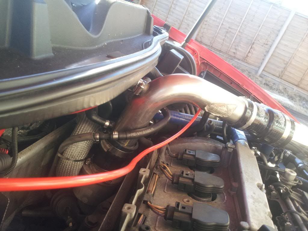

Is there an after market part that can be used for fmic fitting?
I'm currently running a modified std pipe but it runs across top of engine, I'd like it to run around it less heat, less fouling of the bonnet
Any suggestions?!

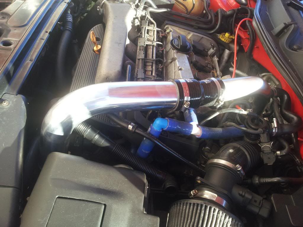

Im running with the Toyosports kit and it goes the same way round. If you want to keep the standard routing, you need to go "same side" FMIC or you will need to track down a Cupra inlet with the throttle body on the other side.
