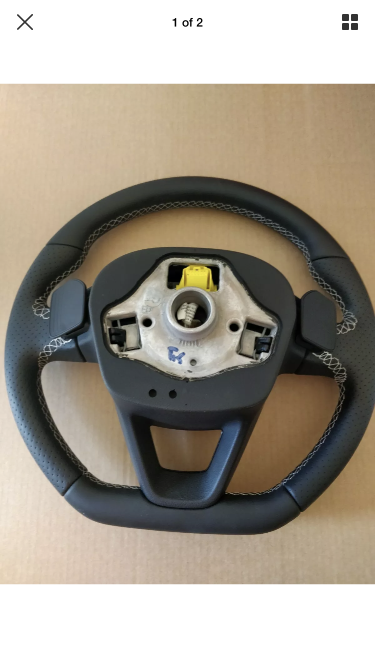

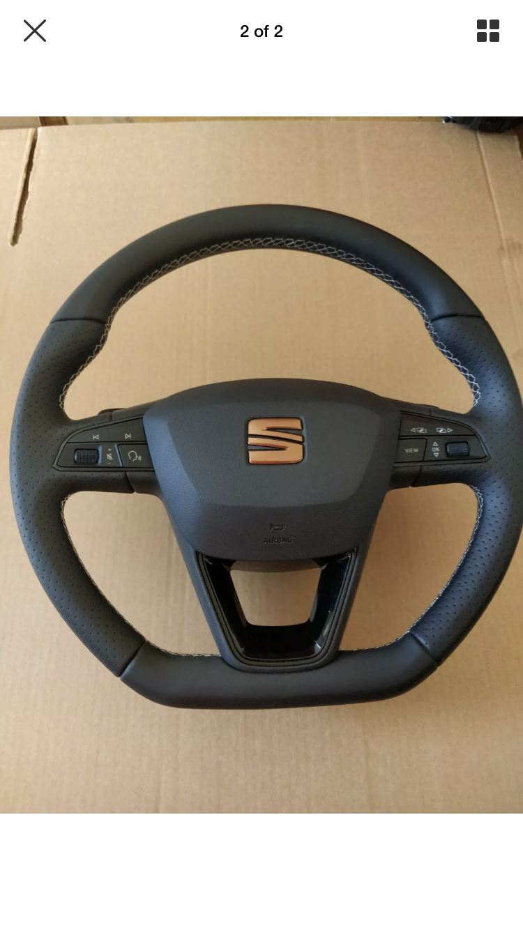

Hi all am new to the forum I have just tock delivery of a seat Leon st 2.0tsi 190 DSG excellence lux. the steering wheel does not have paddles even though the brochure displayed paddles for that model. I have sourced a genuine seat steering wheel with the same multifunction buttons I have on my original steering wheel but with the paddles. should this be a straight forward swap or do I require anything else? any help is much appreciated thanks
From what ive seen/heard its a straight swap, don't forget to take all precautions regarding the Airbag!
Reactions: R4uk
Ok as I have bought the below steering wheel fingered crossed once it arrives I will attempt to fit onto the car and would be able to confirm if I was onto a winner or not

I bought an excellence 2.0 Dsg which was never supposed to have one, and fitted one successfully. Note they changed slightly when the SatNav screen got bigger and a couple of the buttons swapped over, so look for a wheel that is either new or from a very recent crash at the breakers. Once this is in you need to code the steering wheel electronics to look for the paddles. I don't recall having to do anything else. Anyone with vcds or obd11 should be able to do this with ease. Unlike some other features it didn't (as far as MY2018 for certain) require SwAP codes which only the dealer can source.
