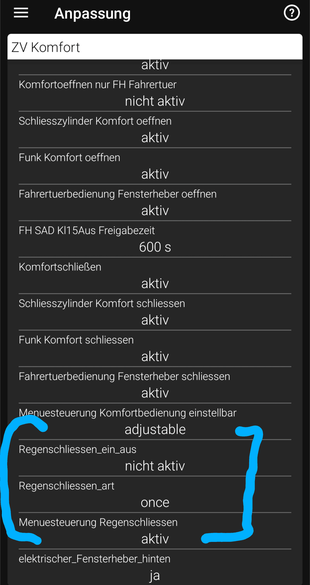

Das Regen Codieren geht vermutlich auch über das BCM, habe das Menü freigeschaltet und die Funktion. Muss es erst testen.

Without the correct RLFS sensor (5Q0955547), the rain closing feature won't work. The newer sensors (such as revision B) are RLHS and will not function to allow the rain closing to work.
Easy way to visually tell is if you have only 2 sensors or 6 sensors on the window mounted rain module.
I understand what you mean, that would have been my information too. But since certain experiences with other diagnostic authorizations, I have to look at the topic again. Because I can activate the function normally via the radio, which is not possible with other settings if the participant who is responsible for it is. So I still have to look into it more closely.
