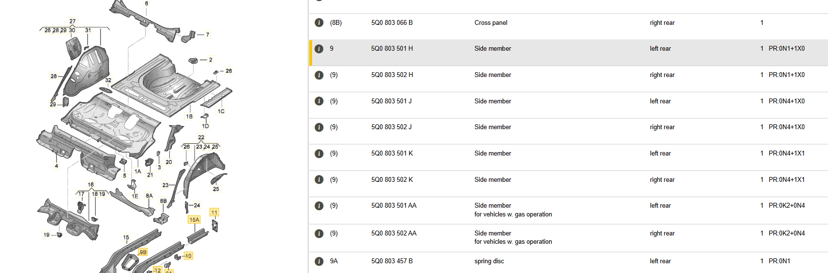

There are different 'side member' part numbers for (0N4) 4 link and (0N1) beam axle - so very much doubt its a simple bolt in job!
If you have to have 4 link independent rear - I would by a car with that.

The IRS has a separate subframe to hold all the arms/links - where as the beam axle mounts directly to the body - which is why there is different body panels between the two.
I am all for trying new things mate - but having to weld in new structural floor panels! I would knock this idea on the head.
