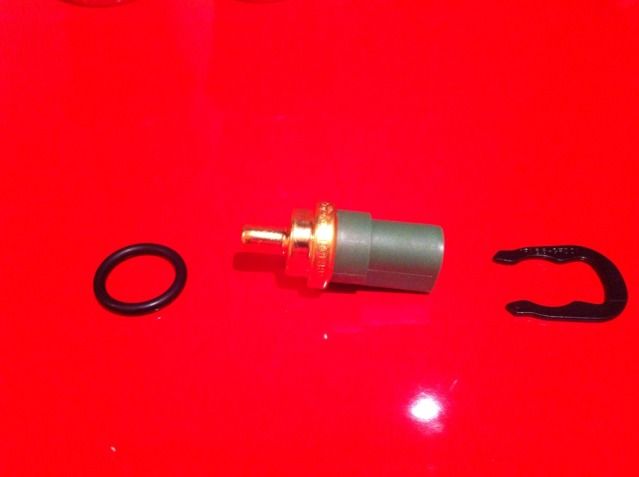

Next up....... get my finger out and replace the dud coolant temp sensor then i don't need to worry about the car struggling to start when cold.
Update people.......
This arrived today and was fitted within the hour
No more sluggish starts in the morning and no more engine management light or fault codes :)
Was a stubborn little fecker to remove and then the new one wouldn't fit in...... Until I realised the old o ring was still in the housing lol.
Quick top up with some G12 and she was fully operational again :)
