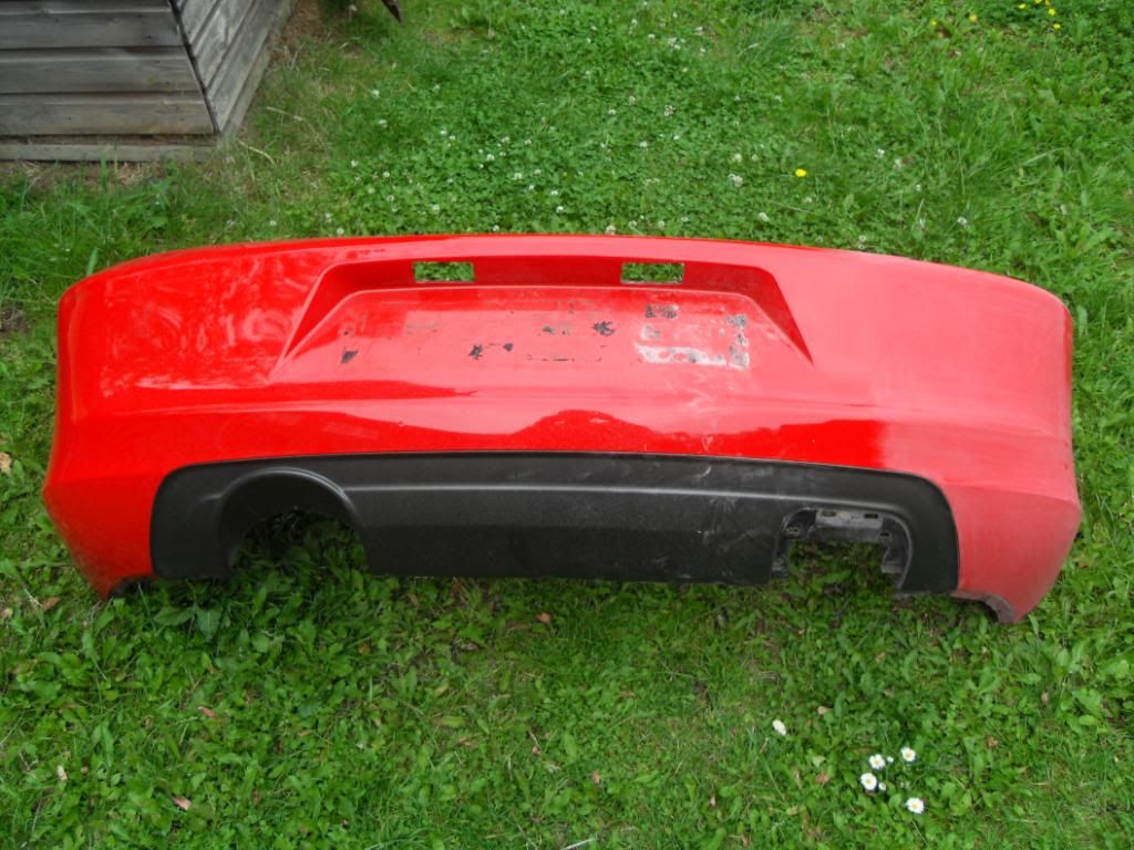

serious?!!! how did you get a color match?!!!!!! that's amazing mate!
how many layers of primer ?
did you sand the patterns down a little? if so, what grit paper?
cupra-barn
It's all about stealth!
Aug 4, 2010
2,105
Worcester
Yep deadly serious. I work for Halfords but I did simply take my paint code and mix it up to the spec listed on our computer. (any store can do this)
Right spec i used :
3 layers of plastic filler primer and sanded.
1 layer of red primer and sanded.
7 layers of paint I mixed.
4 layers of laquer.
I didn't wet and dry the paint at all only the primer.
Over the moon with the results like you say almost a perfect match

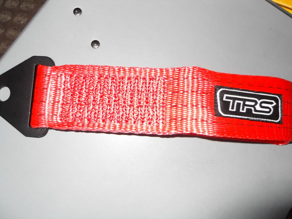

A quick update.
I ordered my TRS towstrap in red on Friday so hopefully get delivered tomorrow. I also ordered some silvatech bulbs :)

Well my towstrap and bulbs turned up today.
The towstrap will be fitted with all of my other bits, the bulbs today :)

Just a short (but very important update) I picked up my LCR rear bumper today AND ordered my LCR front bumper and skirts, LCR brembo's and wheels and LCR roof lining and black plastics. Can't wait for it all to get here proper buzzing!!
