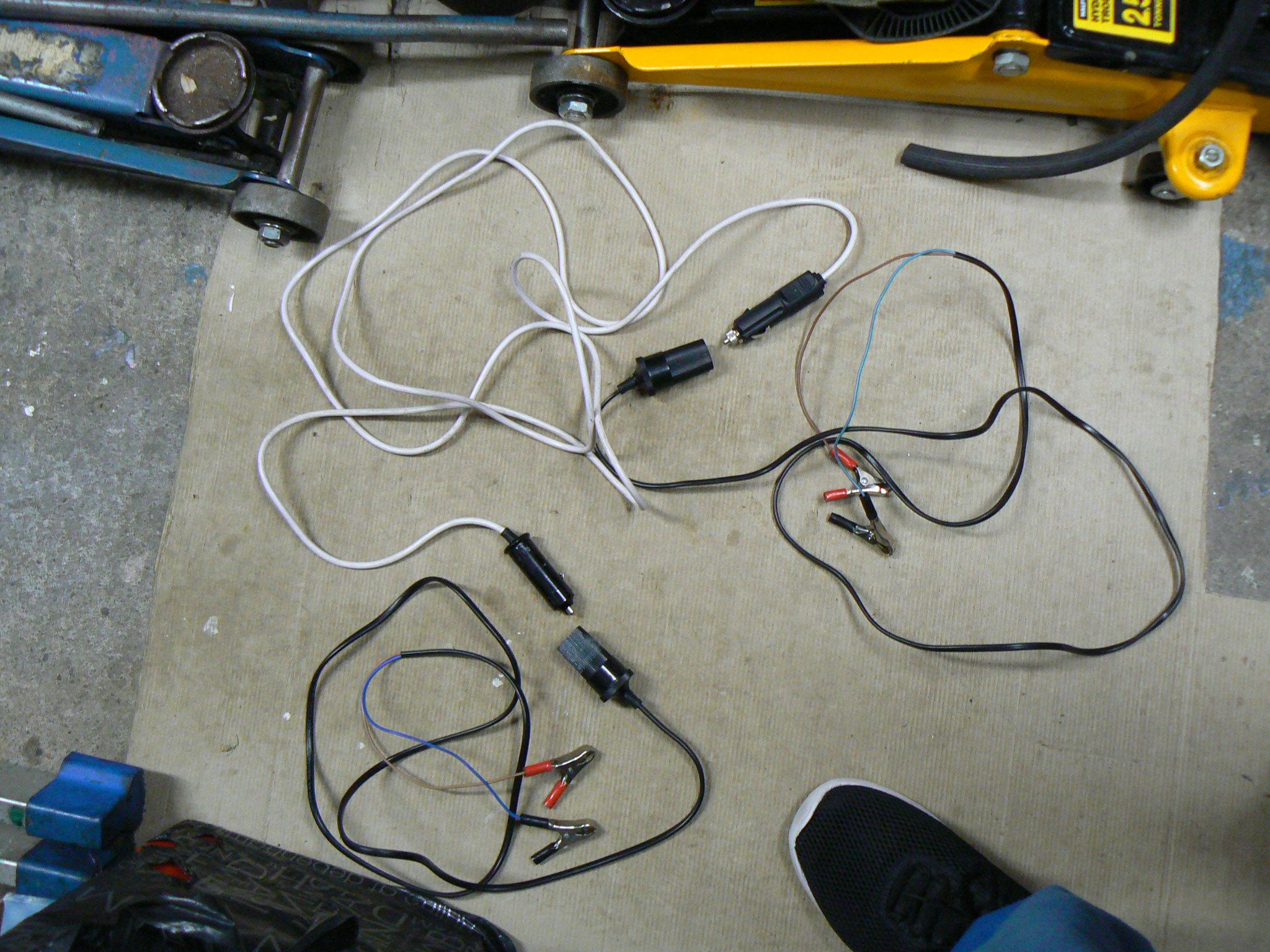

That'll work but the potential (no pun intended) for a short is great - been there, done that. better to buy a cheap power plug that fits your aux/cigar lighter socket and wire it to your spare (other vehicle) battery with crocodile clips. You'll probably need to leave the ignition turned on to get the connection through to the vehicle. Obviously be careful with polarity when wiring up the plug and connecting to the slave battery.
Crossthreaded - I like that idea...I see that cigar lighter plugs come in different amperage ratings so what amperage do I need - and presumably the wire for the leads will need to be the same rating?
Now that's a very good question collywobble! I'll try to attach a picture of my setup. I bought 2 male and 2 female sockets - one turned out to be fused although I didn't buy it for that, I bought it because it has an embedded wee green indicator light - then 2 black crocodile clips and 2 red ones. The wire was just stuff what I had lying around probably the sort of stuff you would wire up a spot/fog light with. My reasoning was that as some of the cheap memory savers work with a wee 9 volt dry battery the current demand, as long as I didn't twist the ignition key round to the starter motor position, would be minimal.
I stuck a male socket on either end of the white wire and then wired crocodile clips, on lengths of the black cable, to the female sockets. So, if I connect the female sockets to the males I end up with a long wire length with crocodile clips at either end to go battery to battery direct. Remove one of the female connections and I have a slightly shorter run available but with crocs on one end and the cigar lighter socket on the other so I can go battery terminals to cigar lighter. Take the croc lead off the other end and I can go cigar lighter on one vehicle to cigar lighter on the other.
This all looked great until the first time I tried it. absolutely nothing happened and I lost the radio code and front window memory on my boy's Astra! How can this be? After a wee bit of continuity checking it was obvious no current was coming through the white centre section. Of course there's a fuse in the larger of the two plugs which I hadn't taken notice of - and it was blown! (it's a very small capacity fuse, like something you'd find in a radio feed) So, again "guessing" that current demand is going to be low, but obviously not that low! I soldered a bit of wire across the fuse and bingo! all working good. To this day I couldn't tell you what the current draw is but I've used it on quite a few cars when needing to disconnect the battery for any reason (change of battery, timing belt work, etc, etc) and it works a treat with no sign of the wire heating up. I really must get round to sticking in something like a 5 amp fuse one day.
It now doesn't see much use as I've got a fancy CTEK which can do maintenance voltage so it can take the place of the battery instead. However I'll not be chucking the wires away anytime soon as I can use them anywhere whereas the CTEK needs to be plugged in to work.
