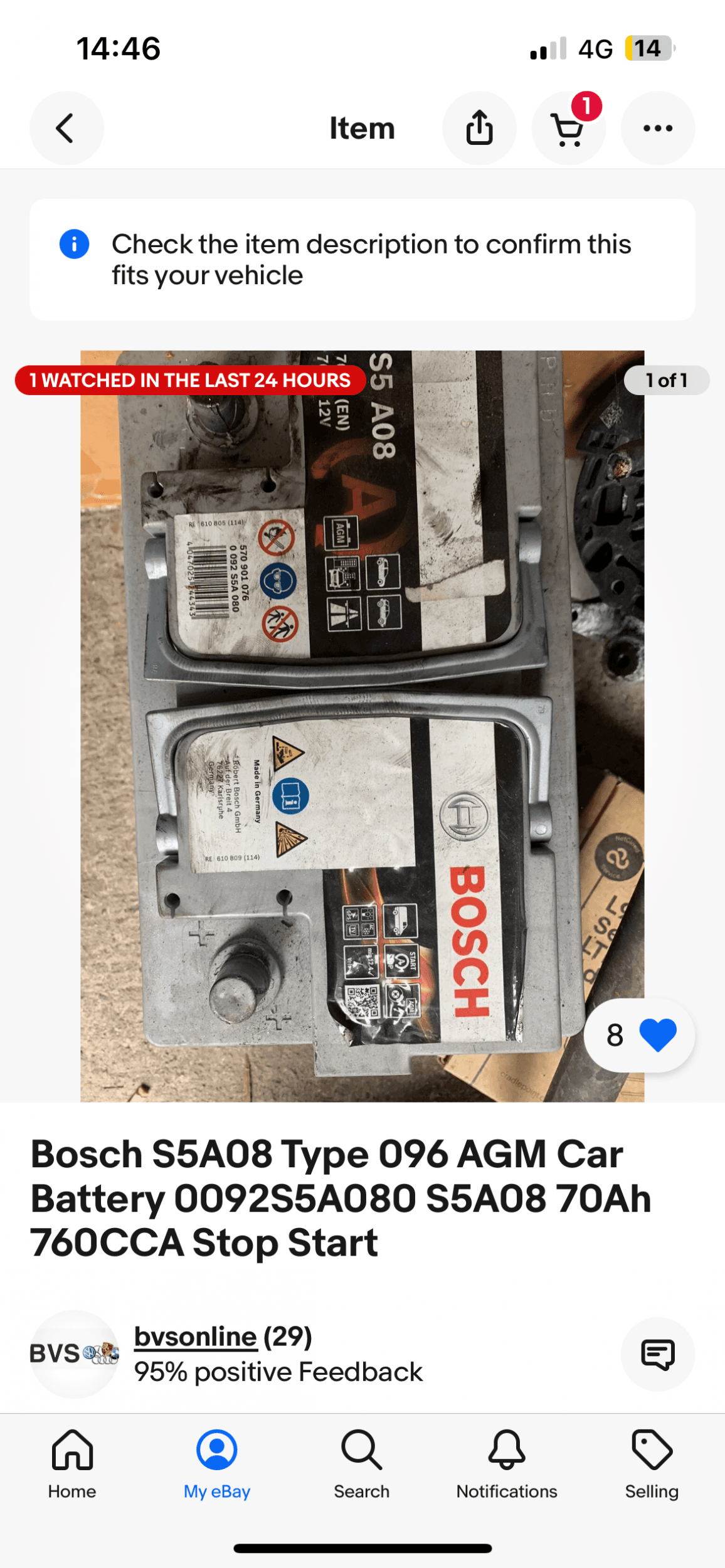

Thanks for the reply bro yeh il post the link below

Couldn’t get link up to post it but that’s the add brother he’s a breaker and sells them all the time he says and for £50 it’s AGM aswell ??
So could I code it using a OBDelevn vag dongle ??
Yes, OBD eleven will sort it no problem.
When you swap out any battery for another, either used or new, it needs to be coded. Serial number to be changed, and also check the charge capacity is also the same. If not, change it by coding to the value of the new value. The adaptive charging in the car won't work properly without all the settings being right, as an example, I found that until I coded my new battery on my wife's Toledo, the start/stop didn't work as it should.

A good quality battery has an average lifespan of 4-6 years, after that you can start to get issues like cell failure. I've had batteries last up to 8+ years without issue but that is the exception and not the usual rule.
I'd avoid a used battery unless they can confirm the week and year of manufacture. For all you know that battery could be 10 years old and last you a month.
Also, AGM batteries don't react well to being fully discharged and you have no idea if this has been fully discharged and if it has, how many times.
Even though that add mentioned warranty, that's just a copy/paste from the Bosch website or alike and that wouldn't be valid for a used battery as it's 4 years from original date of purchase. Used it's nothing more than a doorstop when it breaks.
It's not that much more to get a good quality new AGM battery like Varta or Exide from places like Tayna.
Reactions: Walone
For me it's a big risk buying 2nd hand. You can get a new warrantied battery for just over £100 so why take the risk?

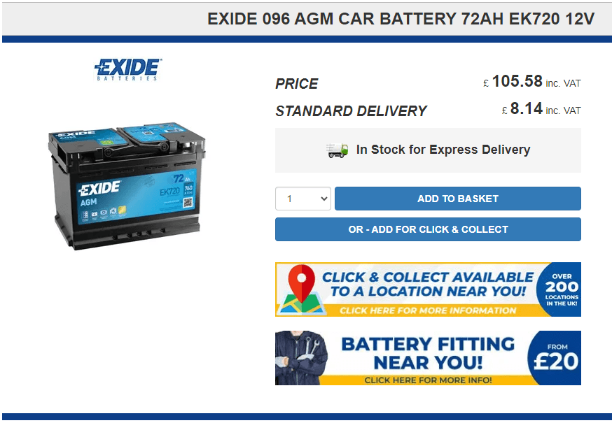

thanks il be ordering that today brother
Quick question bro the one currently in my car is 68AH this one is 72AH will that make a difference ? More so will it be ok and run properly without issue as it’s more powerful ?
As long as the battery fits it's ok with 72AH. When you change battery parameters don't forget to adjust capacity from 68 to 72 AH.
