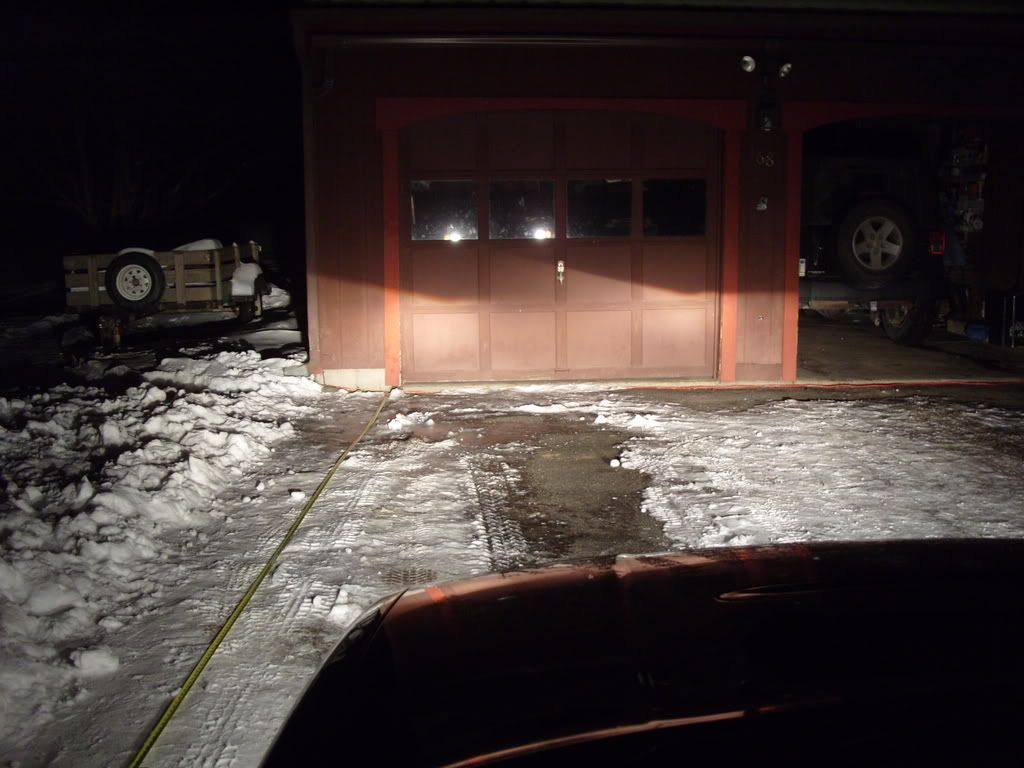

looking at your picture, i think your left light is wrong, either its adjusted down into the ground or the bulb is fitted wrong in the socket.
try to park the car 2m in front of a wall, and you can see it clearly, the horizontal line has to be the same hight for both right and left.
