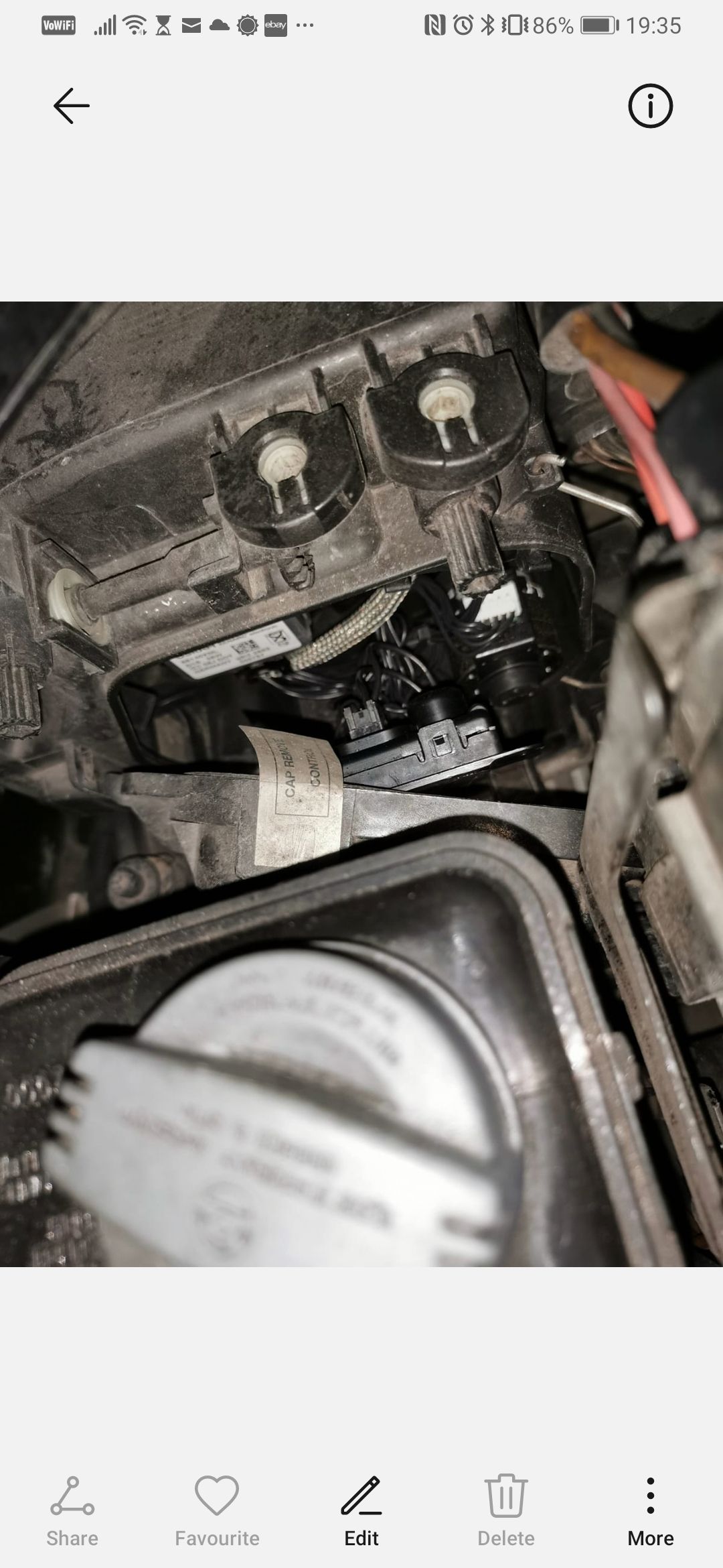

What headlight is the from as mine is an exeo but the black module is just at thd back of light behind cover
It works fine with new build height adjusts etc but blown after 4 weeks. Need to stop the moisture getting in I think
