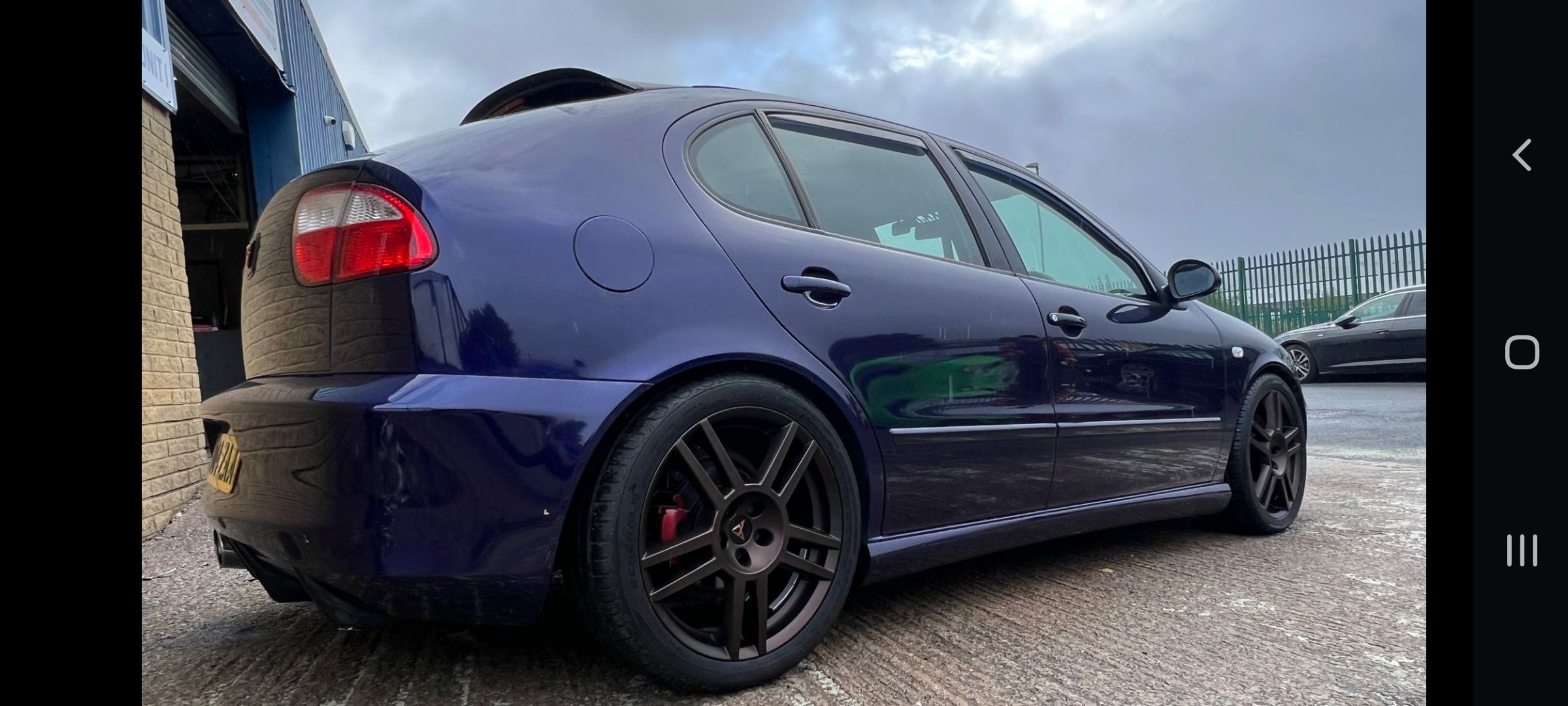

It is a good set up, and a great price compared to bilistain shocks the company that owns st is kw suspensions so quality is there. If you have gone same route as me I'm sure you will be happy, also worth changing out the top mounts for fresh while you have them off, go oem as Polly mounts will drop you another 10mm.
This is mine

That's the ticket! Damian quoted 660 for the set up, seems very reasonable and that height is perfect wow
