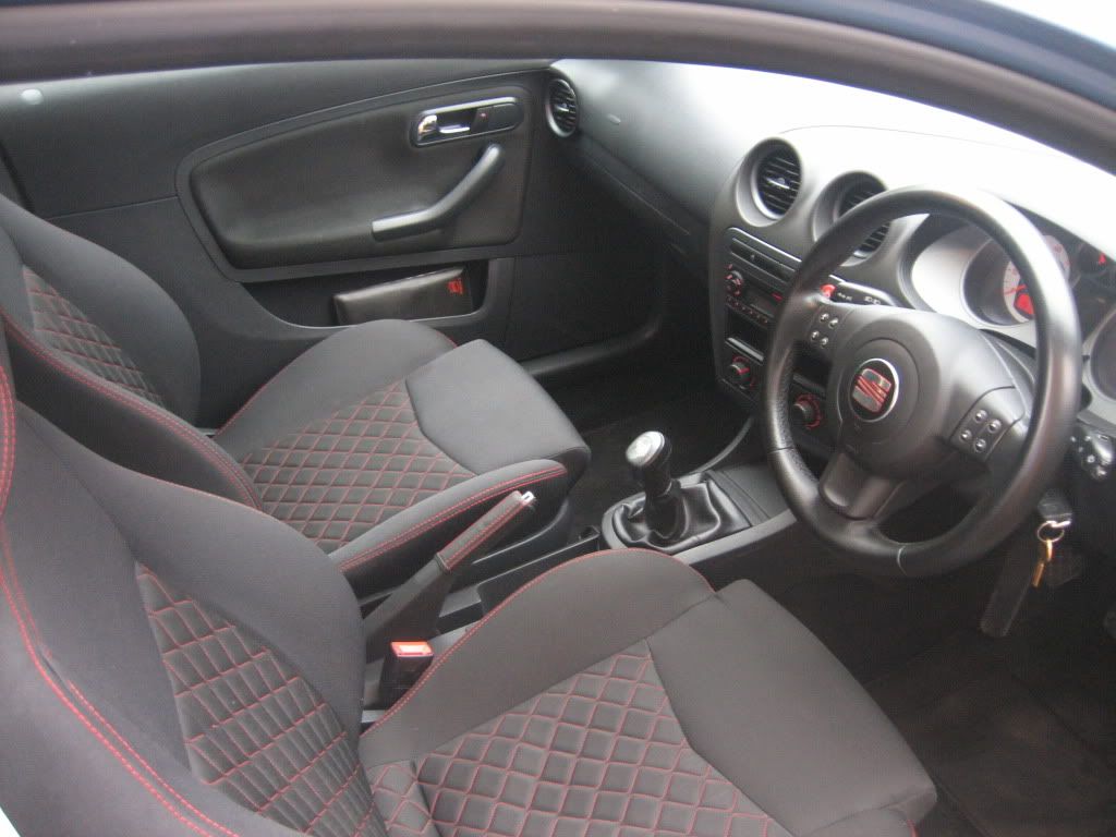

by the way i think your car is looking very well, that interior has made one hell of an improvement if it was anything like mine inside. i get backache if im in it longer that an hour lol
Cheers mate, yeah I can honestly say it is now a lot more comfortable, I've yet to do a particularly long journey since fitting them, but the height adjustment has allowed me to sit lower and I think now I sit straighter in the car, not crouched and bent over the wheel if that makes any sense at all :lol:

Yeah go for it mate! Took me a while to find these though... searching for SEAT seats is an absolute ball ache and a half, eBay doesn't know the difference between a SEAT and a seat. :happy:
yeah i know what you mean dude. im 6ft2 & its got no height adjustment on mine. im holding out for a formula sport interior though. black with red criss cross stitching on if you know which i mean. i was offered a full cupra interior the other week but with the seats in them saying cupra on them i wasnt keen.as much as i like them i dont want to badge it up as something its not if you get me.
6ft 2 with no height adjustment... I feel your pain. I'm only 5ft 8 :lol: but found myself hitting my head on the roof... doesn't happen now thankfully :D
I thought the same as you, I had the opportunity to get FR seats a number of months ago. Like you I didn't want to badge it up as something it's not.

I have height adjust on my old seat! New ones have it on passenger as well! I had to switch the compartment from old seat though!
My old ones just didn't have it all, the new ones have it on both front seats... double win :p
