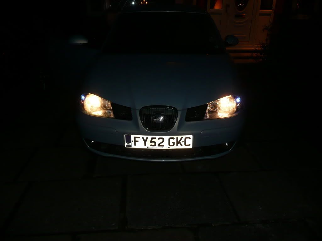

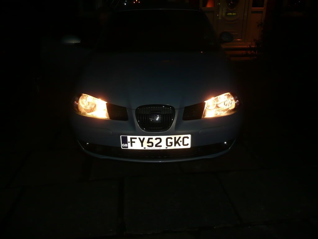

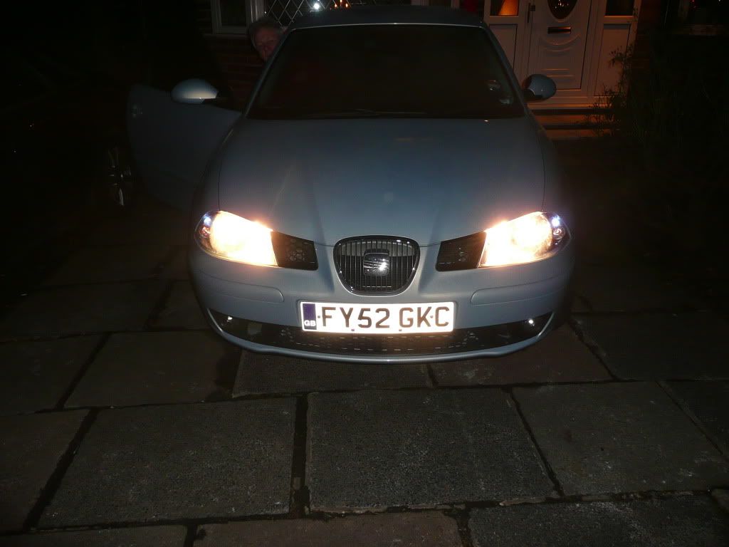

Here's a picture of all the beams to show they all work properly.
Dipped beam only
Main beam and dipped together
(excuse the dodgy looking Dad poking his head out of the car! LOL)
And finally, when main beam is being flashed without dipped beam being in ON position (the fact the sidelights aren't on is the giveaway!)
