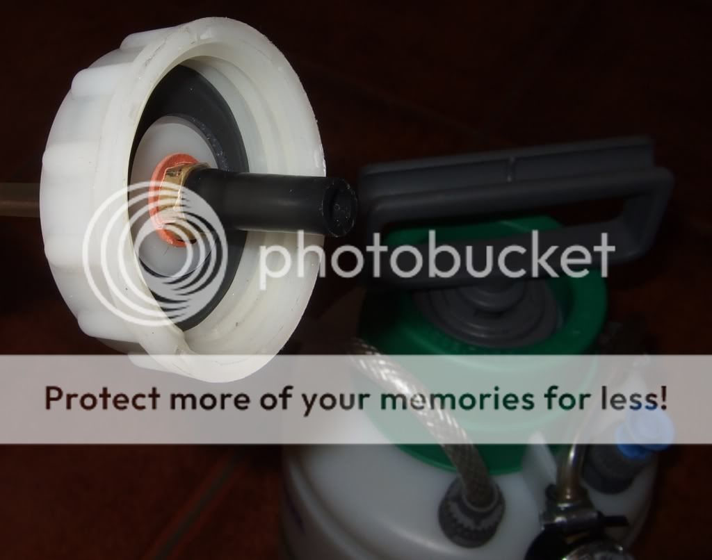

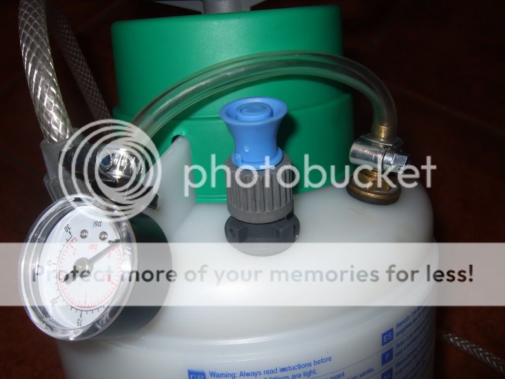

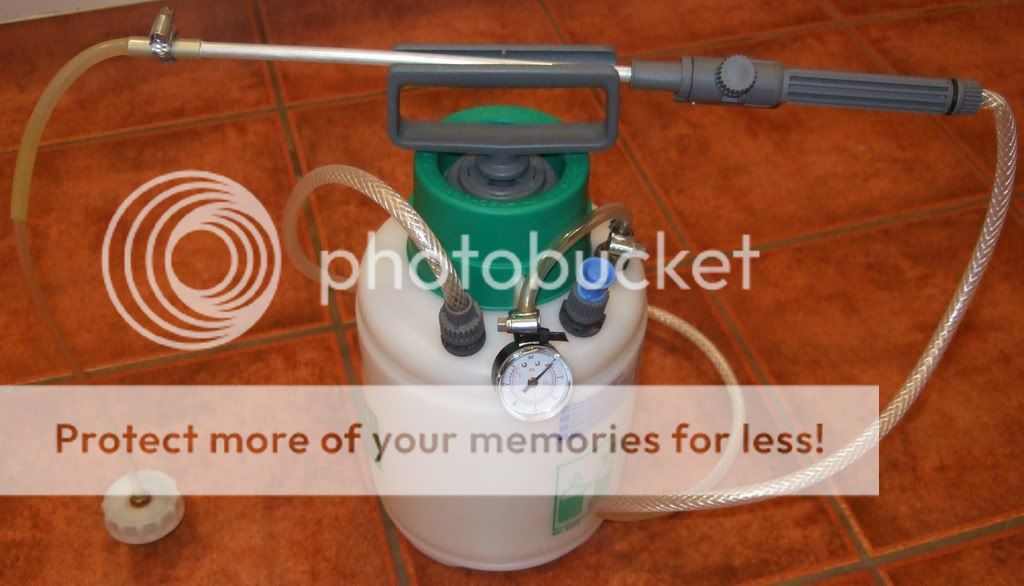

I tried one of the eezi bleed kits and it leaked pressure. The vessel doesn't hold much fluid either, so I took it to bits and made a pressure bleeder out of a hozelock 5 litre garden sprayer and the eezi bleed bits. I put a pressure gauge in it as well so the pressure can be monitored. I'll post up some pictures if anyone is interested.
Here you go, It's got a pressure gauge, pressure release valve and an on/off trigger. Made from a hozelock killaspray, an eezi bleed kit, a bit of hose, pressure gauge, a couple of jubilee clips and a brass adapter for the gauge to tap into the bottle. It holds 5 litres so you don't worry about running out of fluid and you can keep the pressure constant with the hand pump. It blows the fluid through from the reservior.

yes it was mate, exactly the same kit. Make sure you get the Hozelock killaspray as the cheaper ones don't have the pressure release valve (so when you take the cap of the reservoir brake fluid doesn't go everywhere). Cost me about half the price of a manufactured one and works prefectly. It's good to have the gauge to keep an eye on the pressure. you don't really want to go above 9 or 10psi.
The join from the lance to the pipe is done with some flexi windscreen washer hose, it's pushed on nice and tight - needed a bit of fairly liquid as a lube - and doesn't blow off no matter what pressure you pump it up to. The reservoir cap is exactly the same as it was in the eezibleed except for the short length of black pipe on the inside (again on nice and tight). That is there so when you pull the release valve, it'll suck the excess brake fluid back so the reservior is automatically on max when you've finished.
When you drill the hole for the tap into the pressure gauge, make sure you can reach it with your fingers through the neck of the bottle as the big green lid doesn't come off. :)
