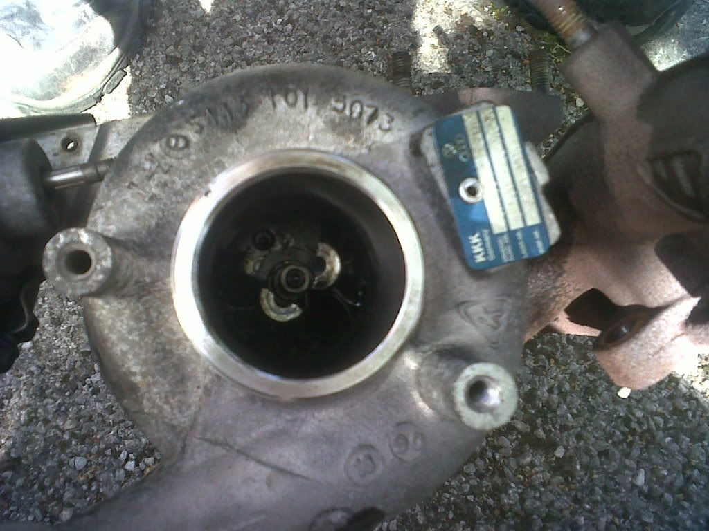

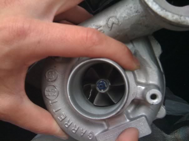

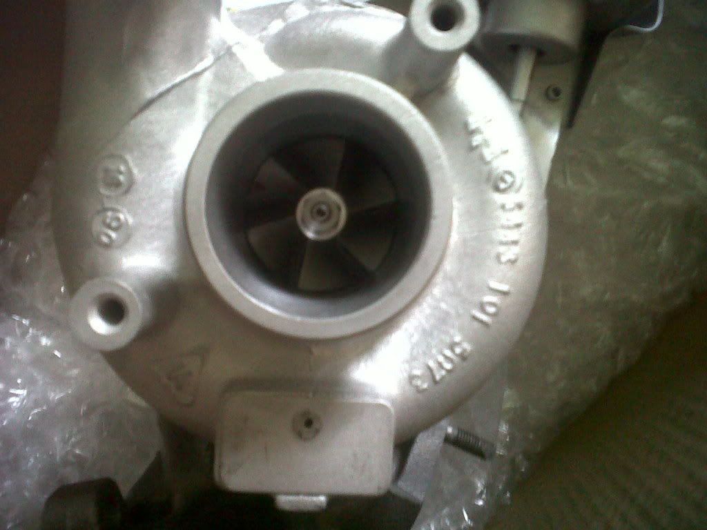

Shaft failure, check this out, my mates hybrid turbo ;)
Check mine out! Lol
Blown..
New...
