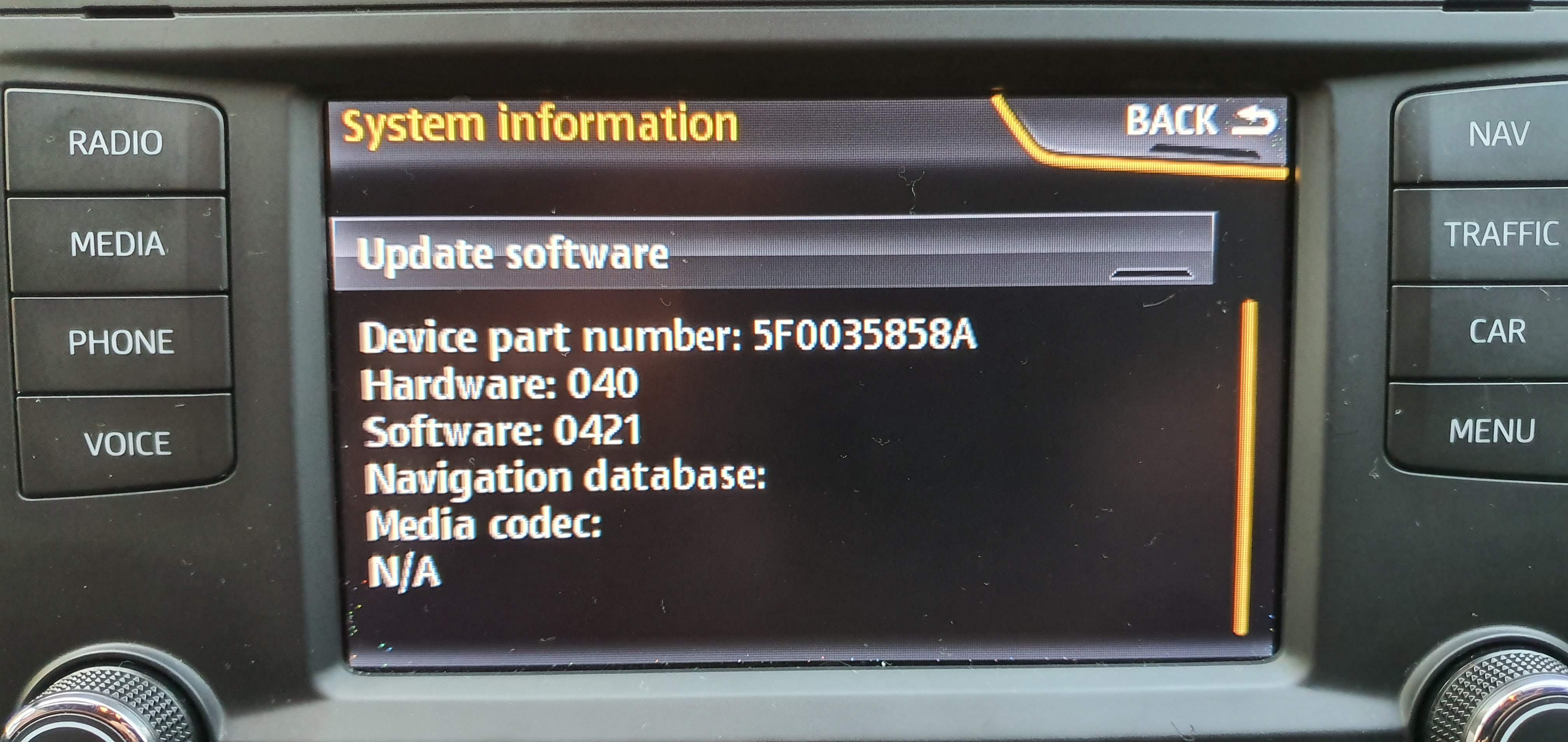

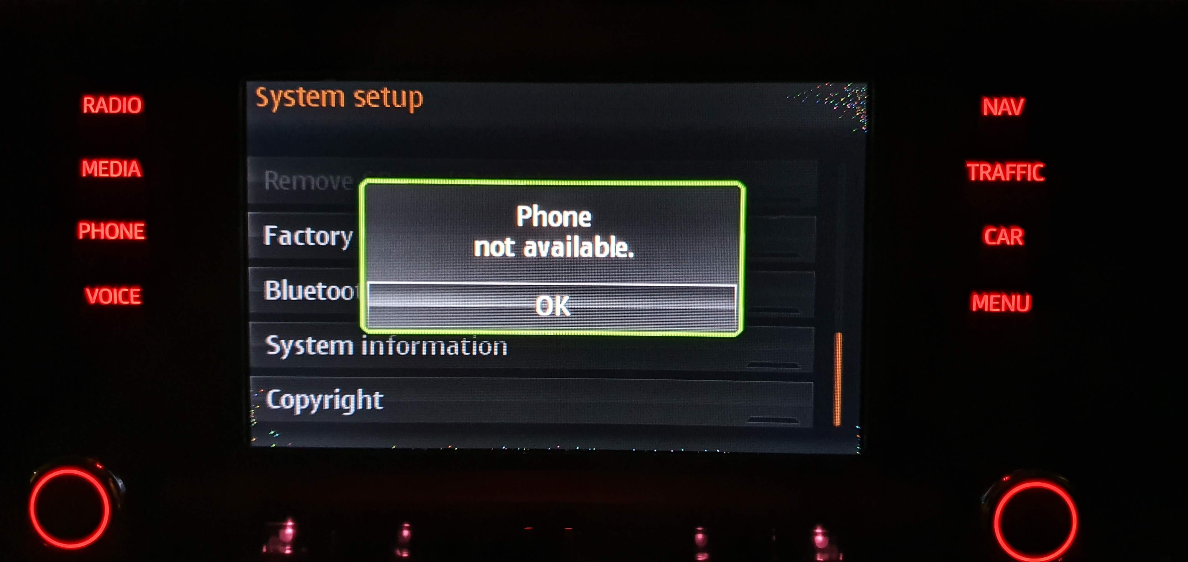

When pressing 'PHONE' or attempting to access Bluetooth settings in the System setup menu, I get the attached error message stating "Phone not available." 20190908_213800.jpg (also, here's the System information screen: 20190908_190523.jpg )

I tried the factory reset in settings yesterday and it reset everything except the bluetooth settings. It seems the previous owner had two phones connected and had set the visibility to 'hidden'. So the system was trying to connect to phones that weren't there and I couldn't connect my phone because it couldn't see the car.
Resetting via the power button gave me a brief window to find my phone from the car system. Now connected, I have access to all the settings so I've removed the old phones. Time will tell but I think it's sorted.
