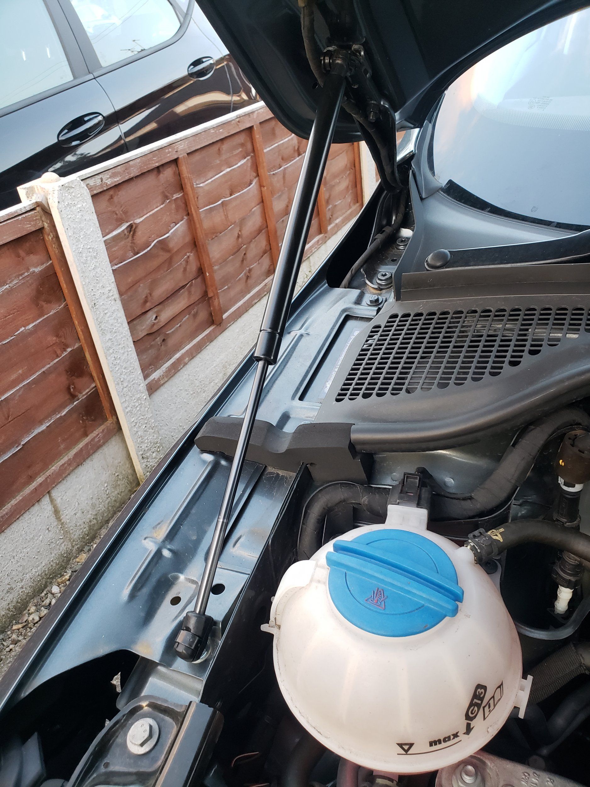

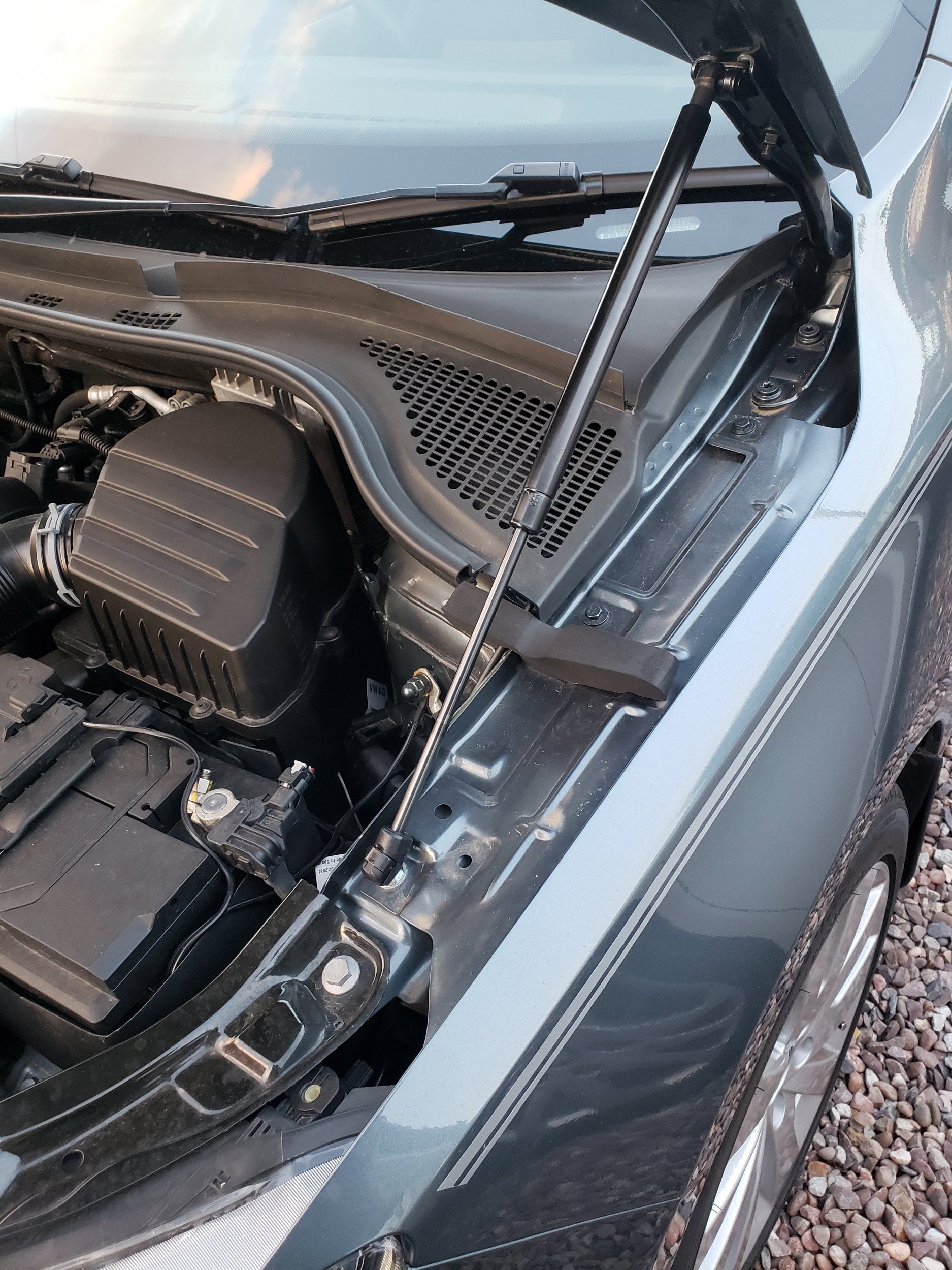

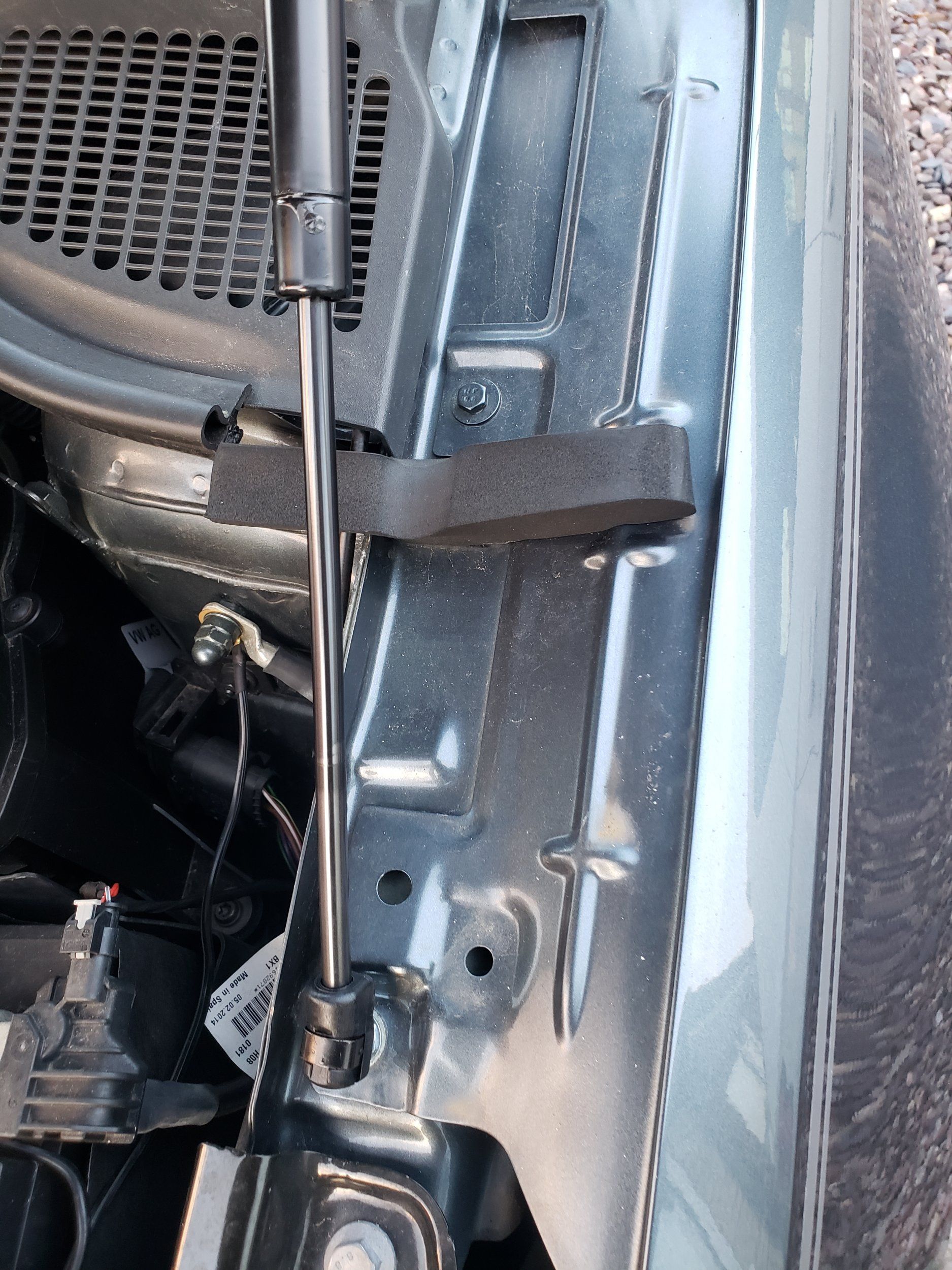

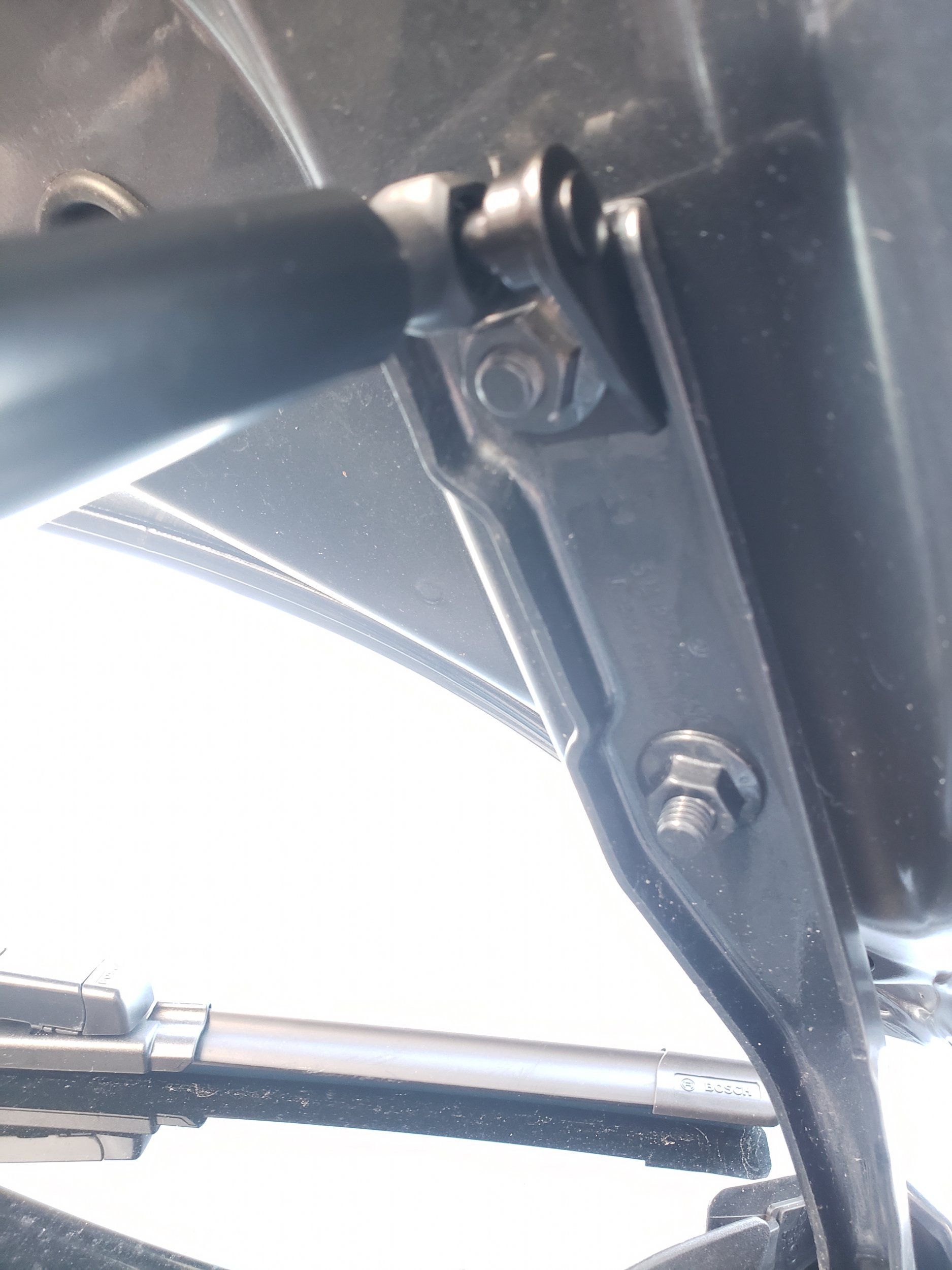

OK, took the plunge and ordered a set of gas rams from Ali Express. Just less than £18 including postage from China, and they arrived in 18 days. Literally 10 minutes to fit. Very pleased with the outcome of these, certainly a nice little upgrade for minimal cost
