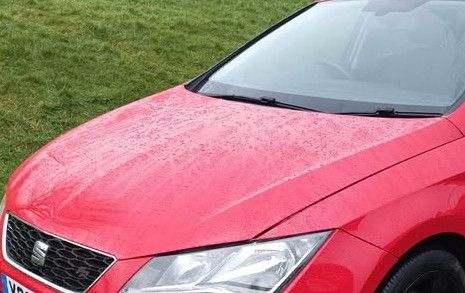

I could use some advice on the gap sizes around the bonnet. I bought a Cat N car that had a bit of a sloppy repair job. Before the repairs, the damage was minor—just the fender, bumper side, front grill (minor damage to the front), and the bonnet.
everything was replaced, but it hasn't been properly adjusted. Can anyone guide me on the correct gap sizes between the bonnet and the fenders, as well as between the bonnet and the front of the bumper? Right now, it seems like mine just lay on top and shifted to left side more. Thanks a lot

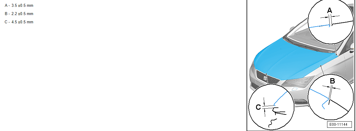

WOW, I need to up my googling game. Thanks a lot.
now I just need to get a proper distance between parts in mm .. time for ruler and find a neighbour with Leon :D
