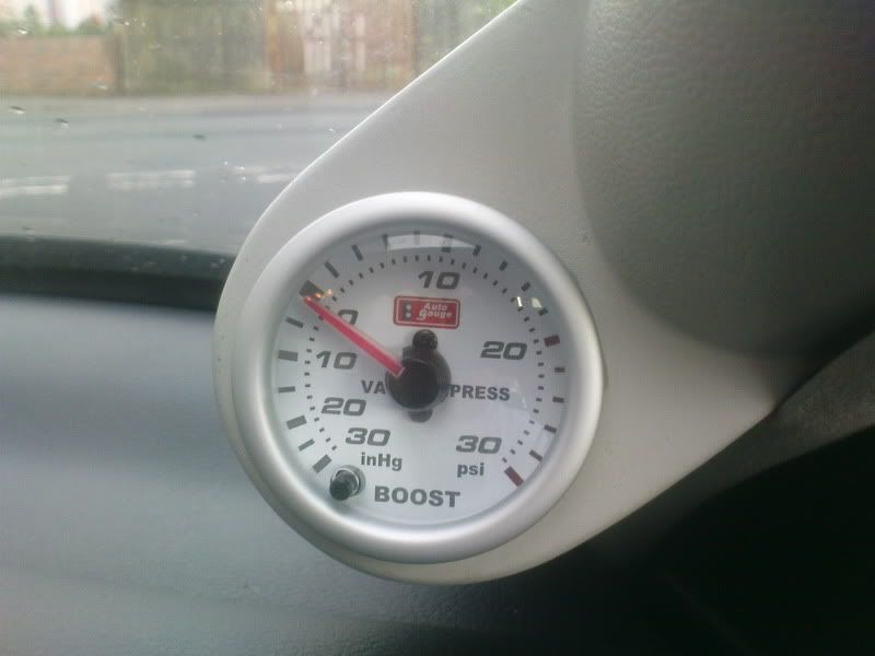

Cowie have you got a pic of your boost gauge installed? Curious to see what the Halfrauds one looks like setup..

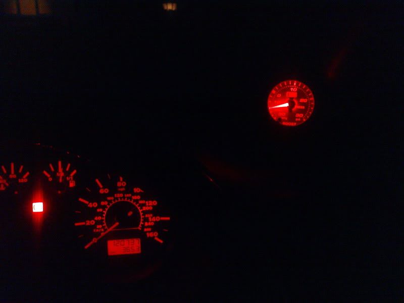

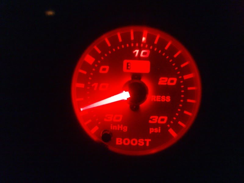

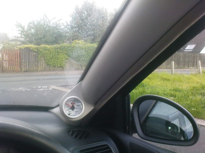

sorry Tom took so long mate,here you go.
At night,great match for OEM dials

looks good mate was thinking of doing this myself but wasnt sure about how it would look.
You may have convinced me to get them now :D
