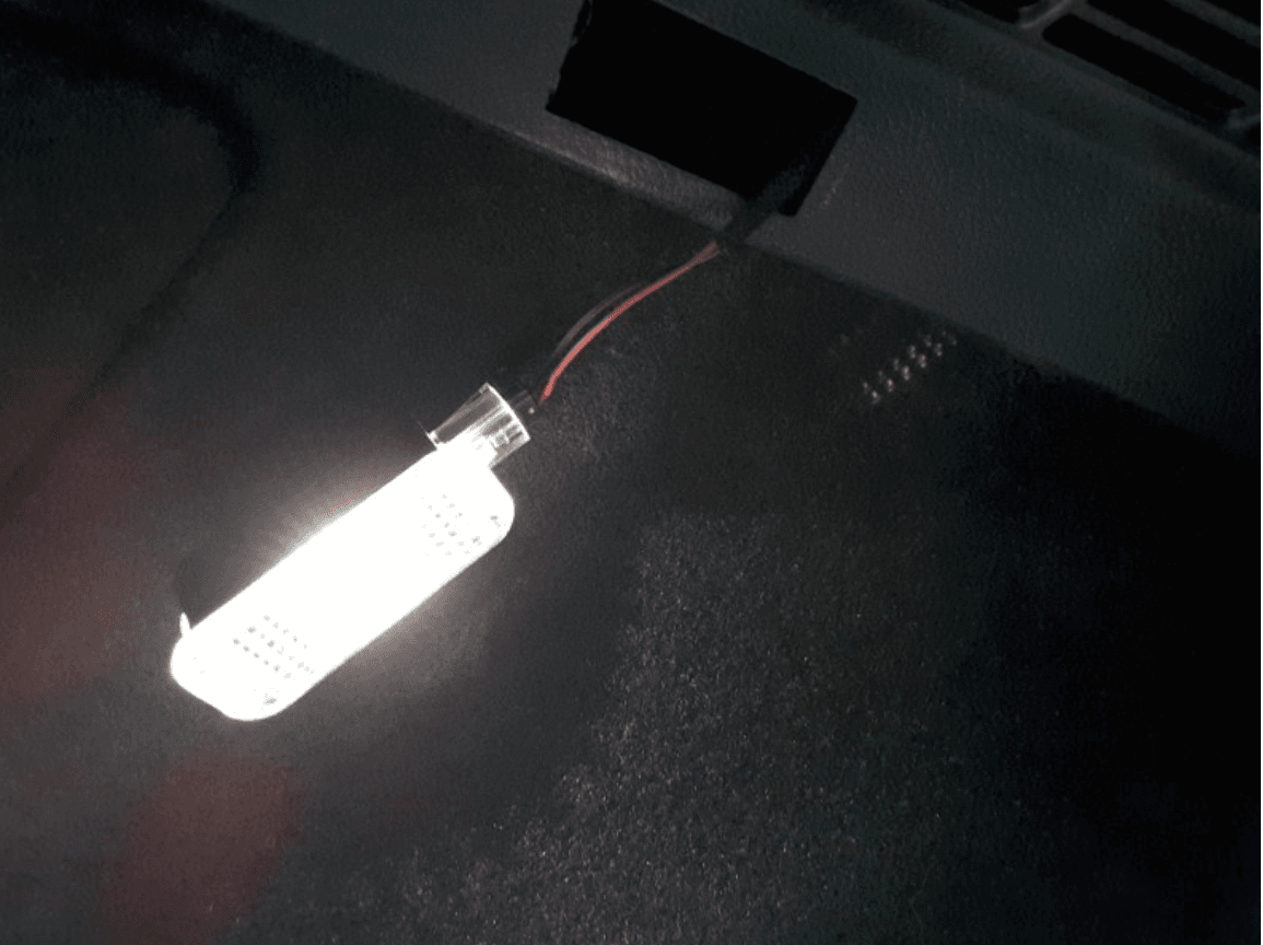

An annoying one this, especially as the dealer I got the car from is 200 miles away! I’d noticed the lack of a boot light, and thought nothing of it, until air found out there was actually one. But mine wasn’t working. I’d also read it wasn’t very bright, so to kill 2 birds with 1 stone I bought an 8 LED replacement. Today I wen5 out and popped out the original, an£ discovered why exactly it wasn’t working.....
I wasn’t connected to anything, and indeed there appears to be nothing (as in no wire dangling about) there for it to connect to - fantastic quality control!
Untitled by Richard Fletcher, on Flickr
old and new...
Does anyone have any pictures of what it should be connected to?.

If anyone wants to brighten their luggage area I can recommend the 4 LED version of this
https://emtuning.co.uk/product/audi-oem ... ade-bulbs/
A bit fiddly to dismantle the existing light unit but fit perfectly, will also fit cabin floor lights

Oh, I popped the orginal light out in about 2 seconds - but there was no wiring connected to it, it just fell out. I was hoping for photos to show what wiring should be there, when I go searching with my mirror-onna-stick.

I suspect your original wiring may be dropped down inside the car. Someone pulled yours out and let the cable drop.
I did un clip mine many moons ago and read the serial number of the back.
8J0 947 4098
Same as the foot well lights in LED which is why they are interchangeable:). Picture of it when I pulled it forward... and didn't drop the cable :).
Think you need to go looking for a loose cable down the back / the loom socket if never fitted. No doubt those cables will be sold if missing.

Yep, hence the mirror on a stick I've ordered. I certainly didn't pull the light off a cable - when I popped it out it literally fell out into the boot.
Tell
Full Member
Was that a brand new car, dealer demonstrator or second hand?. Suspect someone has fiddled with it rather than a build issue unless they just failed to clip the cable all the way in during build and it's dropped off.
Will be interesting to hear whether the cable is just laying down the back. Will have to think about Bedlam's light upgrade, it is a bit dim in the boot which is why in 2016/17 I pulled the light forward but seeing it was LED decided there was nothing to be done at that time.
