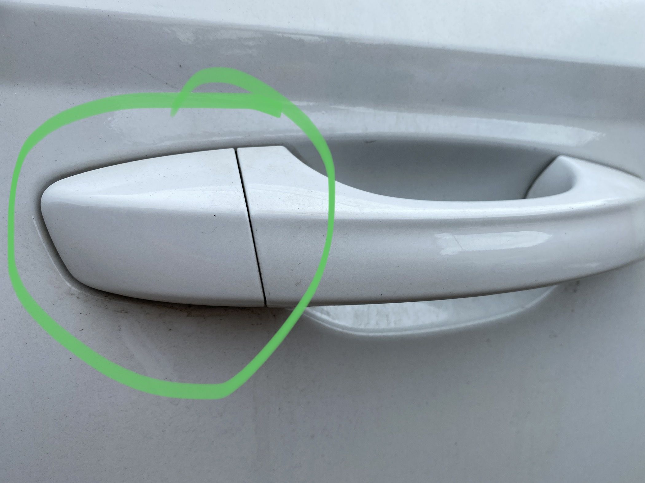

You have physical locks both front doors under these covers.

Main battery then. Don’t forget the car will need a re-program when a new battery goes in, not sure to what extent as my mechanic took care of mine the other day, but you can’t just slap a new battery in and off you go unfortunately.
