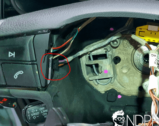

I took some pictures not too long ago for an upgrade I did, so this probably comes in handy now. Put your key in ignition position, then disconnect the battery. Turn the wheel and push down on the spring (on both sides) and the airbag pops out.
Picture of the spring (behind the steering wheel)

You dont need to disconnect the airbag, you have enough room to look around/work on it.

Is that the cable in your pic that I’m needing to check and see if it’s loose / disconnected ? So the actual steering wheel doesn’t need removed ?

Andy being snap happy is not only always welcome as he takes great pics but the plug is in clear view too!
Also check the earths on the airbag itself as the switches use the same earth wire as the horn and airbag and they have been known to work their way off the poles.
Removed clock spring etc and tested with voltage meter and everything seems normal but what I did notice was the black connected going into the steering control on the left hand side seems to move in and out quite a bit, so removed that and it would seem one of the pin connections is broke, going to try solder this evening before buying a replacement and hoping that’s the issue.
