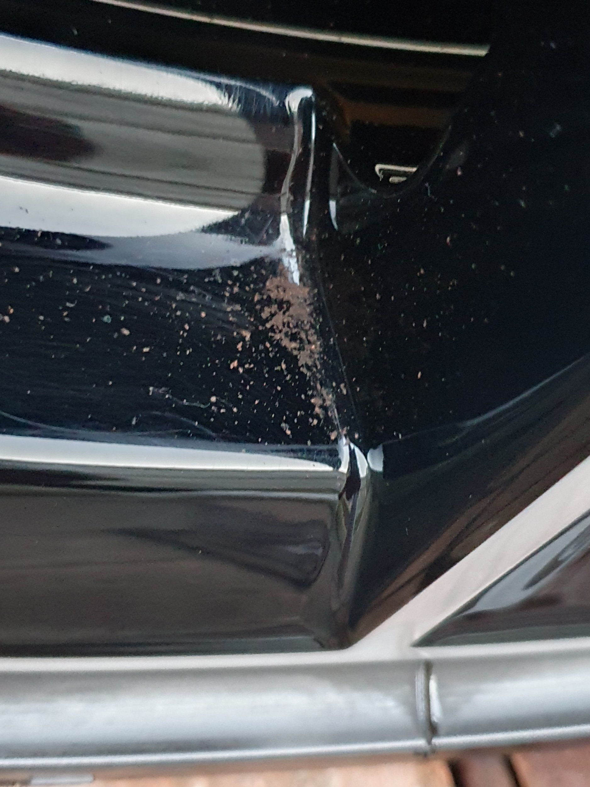

I have noticed this issue on my Cupra, having been a detailer for over 13 years it really bugs me.
My wheels were covered when I first picked the car up from new. Cleaning and Iron remover didn't get rid of it. In the end it tooks hours of using a clay bar and polishing.
What also annoys me is how easy the gloss black alloys scratch, I kinda expect the rest of the gloss black trim to mark easily but not on the alloys.
I was going to coat them with Gtechniq C5 but kinda given up on them now. Lol.

This doesn't fill me with much hope... I've noticed how easy these are to scratch which is also pretty shoddy lol
How often do you wash your wheels?
I would look at using bilt hamber auto wheels to remove the particles then start using bilt hamber auto mac at every wash.
I would also try a old school wax/ sealant, fk1000p has lasted well on my wheels, although not the same as yours.

Maybe once every 3 weeks same as the car, I don't dedicate my life to cleaning but then again I don't drive much these days either lol
Yeah a few people have mentioned that so I may get some...
Every 3 weeks is less than me but i love a clean car
Defo try bilt hamber auto wheels to get rid of what is on there.
Bilt hamber auto mac should stop the discs rusting during your washing routine so should help with any unwanted transfer of particles to your wheels when you drive the car after.
You do need some kind of protection for your wheels though. It will help to stop the brake dust adhering to your rims.
Fk1000p worked well for me.

@Jimbobcook; if your wheels are diamond cut, I wouldn’t use an acid based cleaner as it could damage the lacquer / clear coat and cause discolouration or corrosion to the diamond cut surface.
It will also make a mess of everything behind your wheels - brakes, hubs etc..
