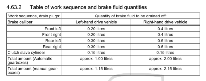

gleno0404 Active Member Apr 16, 2018 10 3 Apr 22, 2018 #1 Hi, Just looking to know if anyone knows how many litres of brake fluid it takes when replacing on a 2.0tdi 150bhp? Any help would be great! Cheers, Glen
gleno0404 Active Member Apr 16, 2018 10 3 Apr 23, 2018 #3 Cheers black sheep. Has anyone any reccomendations re make of brake fluid?
kiddo ST Cupra May 30, 2015 1,144 94 Lancashire Apr 23, 2018 #4 As long it's dot 4 I'd go with cheapest.
