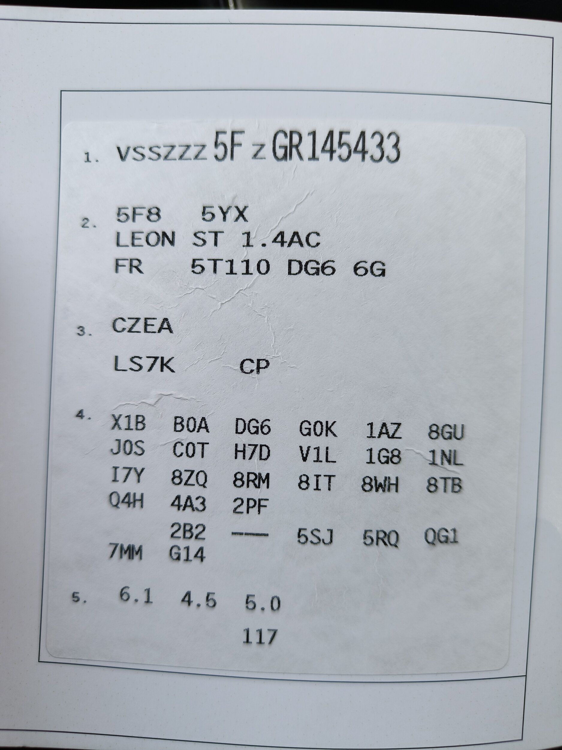

Hi! I don't understand why there are no brake or suspension PR codes in the service manual. Where might I find them? Or could someone help me locate these codes? Thanks
Those are just a small part of the complete PR list and we never got to know how SEAT choose the ones to include there.
I have access to official parts catalog, and since you already shared your VIN, I can help on getting the PR codes for your car, but only in the afternoon when I get back home.
Cheers,
Serdar
Okay, thanks! I can wait!
Here are the suspension- and brake-related PR codes of your car, along with brake disc & pad part numbers in case you need them.
If you're going to buy aftermarket parts, do not just rely on PR codes, as manufacturers are not always thorough with them.
Try to find exact part numbers for your car first, then use that information along with PR codes, to be sure that you'll be getting the correct part.
Hope this helps & cheers,
Serdar
1X0 Front-wheel drive
2H5 Driving profile selection and conventional shock absorber
1Y3 Electronic differential lock XDS, dynamic traction support
1N3 Speed-related variable steering assist - Servotronic
C0T Alloy wheels 7.5J x 18 - Performance 30/1
0AD Front stabilizer bar
0BA Without rear stabilizer bar
L11 Weight category for front axle - Range 11
0YE Weight category for rear axle - Range 5
G14 Shock absorption in front
1JD Rear shock absorption, basic version 2
0N1 Standard rear axle
9U0 Without brake wear indicator
UH0 Parking brake
1ZE Disc brakes in front - Geometry D
5Q0615301H Brake disc - vented - 288x25mm (2 units)
8V0698151S Set of brake pads (1 unit)
1KD Disc brakes in rear
1K0615601AB Brake disc - 253x10mm (2 units)
5Q0698451M Set of brake pads (1 unit)
