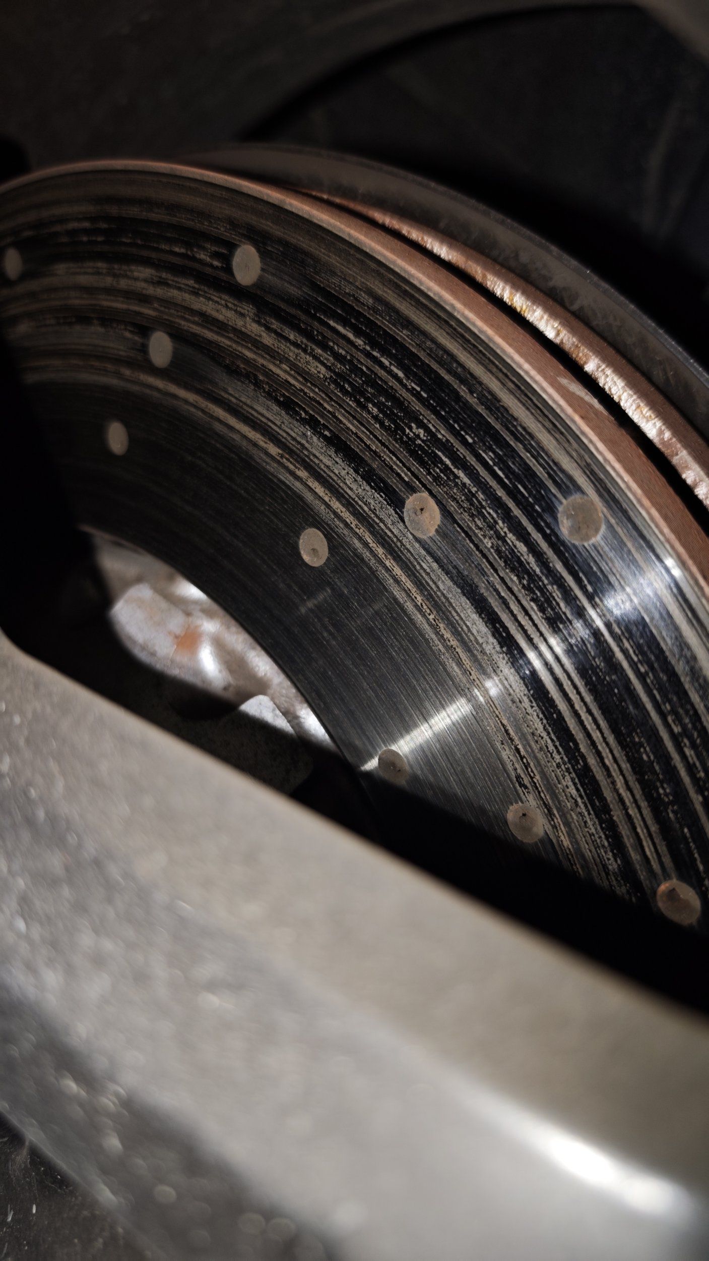

Hello,
By cleaning my car last week (Leon VZ 300) I noticed both of the front brake disk are scratched, and it feel pretty deep.
I did 1 track day back in september, but the disks were looking good until last month.
I asked my dealership, they said I should change both pad & disk in max 5000km (the car have 7500km at the moment).
I'm planning to do 3-4 track day this year, would it make sens to pay more for a higher quality/durability ? Any recommandation for brake disk & pad ? Brembo ?
Or will it just gives me better performance on track ? I'm riding for fun, not looking for the best performance.
Thanks!

Picture? it is most likely fine and having minimal impact.

^^^^ You're OEM discs are drilled / ventilated so ought to be up to the job. I've stuck with OEM discs in the past.
Point to consider is how worn the discs are. There's no point in putting new pads in, if your discs are only going to be good for a further, say, 5k miles.

indeed, I will change disk for sure with the new pad, was just wondering if it's worth to change the model or to take a new set of OEM disks
Dealership said max 5000km or before the next trackday :D
