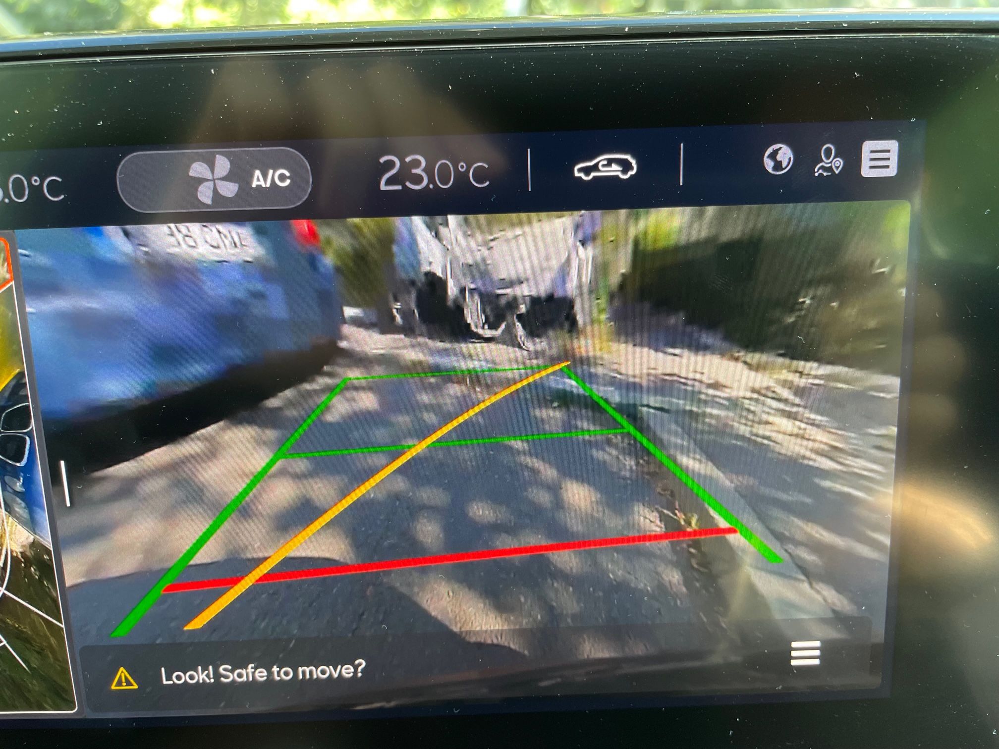

The camera quality is very poor. Somethings I get a BLURR on the upper part of the camera when I try to use it.

Camera seems fine to me, but some people did report very blurry image, I think it was a faulty camera in that case.

I'm comparing to a 2018 Seat Ibiza (my previous car). I tried to tell the service that the camera is buggy but they said that it is FAD.. I can't prove that it isn't.
Attached a photo to show how blurry it is.. but again.. only the top part and not always.

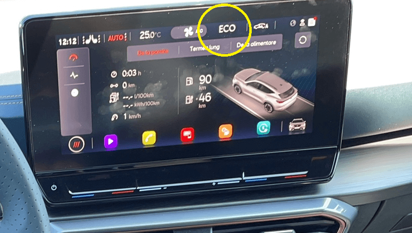

As for ECO, attached another picture. It's always like that.

That camera view looks extremely blurry/pixelated. My camera is better than that.
About the ECO - not sure. I've seen people mention that car detects that there is no passenger and thus turns off the AC on the passenger side. Maybe that is happening here?

Maybe it is.. Maybe if there is no passenger, it keeps that side on eco. However, it does not explain why it took 33 minutes to reach a 90% temperature on the driver side...

Regarding camera quality, I think it's faulty and you should try to get replacement under warranty.

The eco sign on the dash purely indicates that you have no front passenger and the heating on that side is therefore disabled.
Once you have a passenger,the eco sign goes out and heating is activated for the passenger side area.
If its only heating the drivers area,it takes longer to warm up,there's less heat filling the passenger areas.

Presume that’s an eco mode thing? Mine has never showed Eco, but I use individual profile.
Is this a Hybrid feature (ECO)? I haven't seen it in my VZ310.
