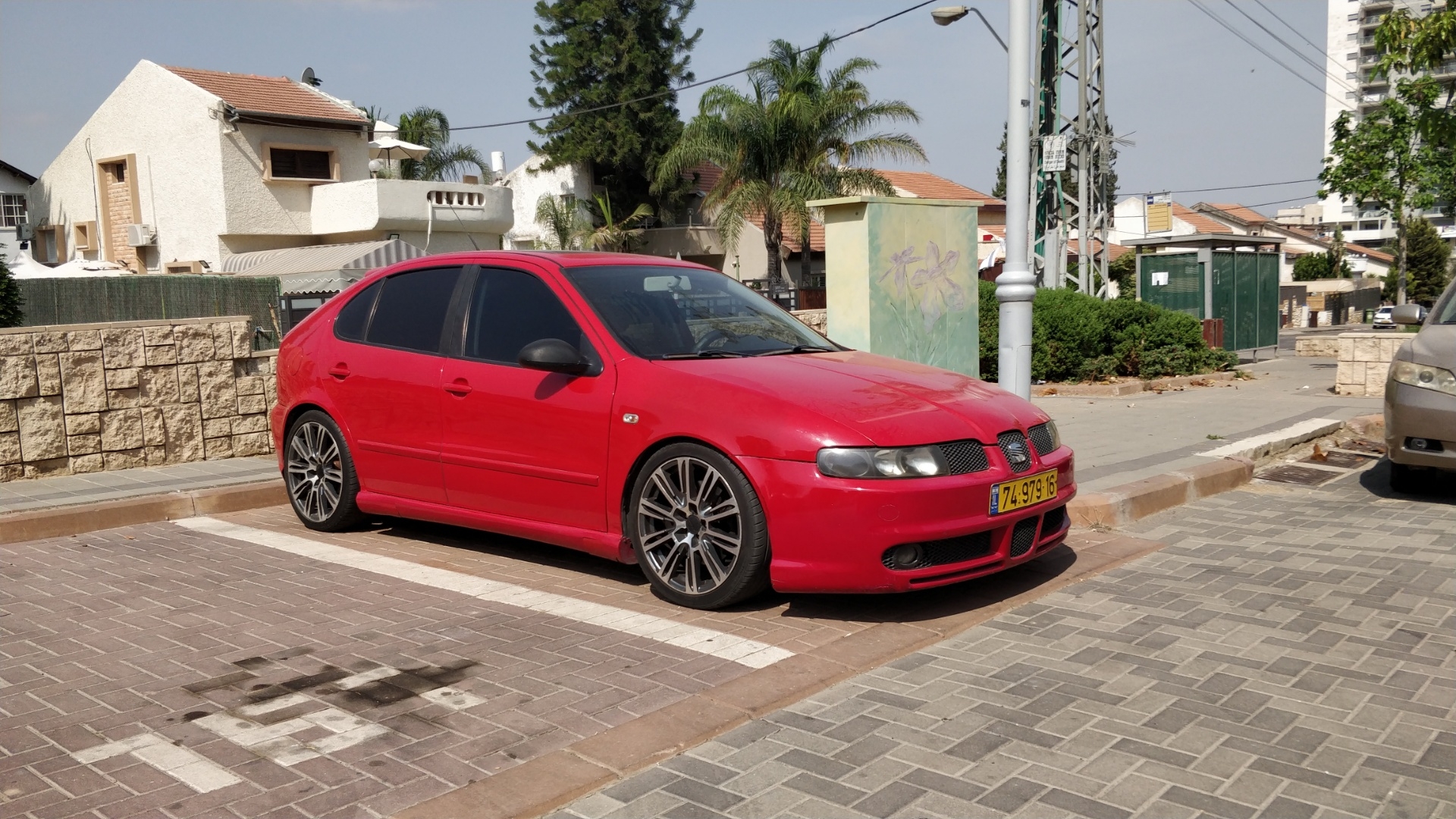

Hey, recently my clutch started slipping
Few garages know well this car and transmission but it's very expensive
So in attempt to lower the price, I'm looking for new clutch kit trough eBay, Amazon or etc...
I couldn't find the right kit for my Leon
I hope someone here know where can I find it and help me...
All I know its a 240mm clutch unlike the 5 gear that is 228mm
Seat Leon 2005 1.8 20VT
Engine code: AUQ
6 Gear manual transmission
Originally 180 BHP, I guess right now it's about 230 BHP (original clutch kit will be enough)
I will be extremely grateful for helping me finding the matching kit!!
