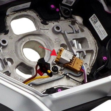

thank you, my doubt remains about the wiring, about the fact that I would be going to mount my original cupra airbag on this different steering wheel, do the wiring also match? I am talking about the small black connector that from the airbag connects to the brown connector on the steering wheel, I attach picture, thank you

Do you already have a heated steering wheel?

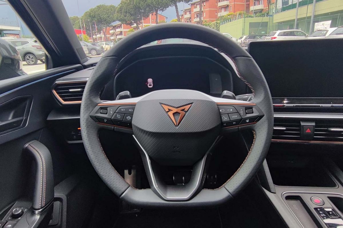

yes sir, actual steering wheel has the same functionality as the one I would like to buy, only the travel assist button changes

then the mechanical conversion should be plug & play. Note: the central screw for the steering wheel should be replaced every time it is loosened.
