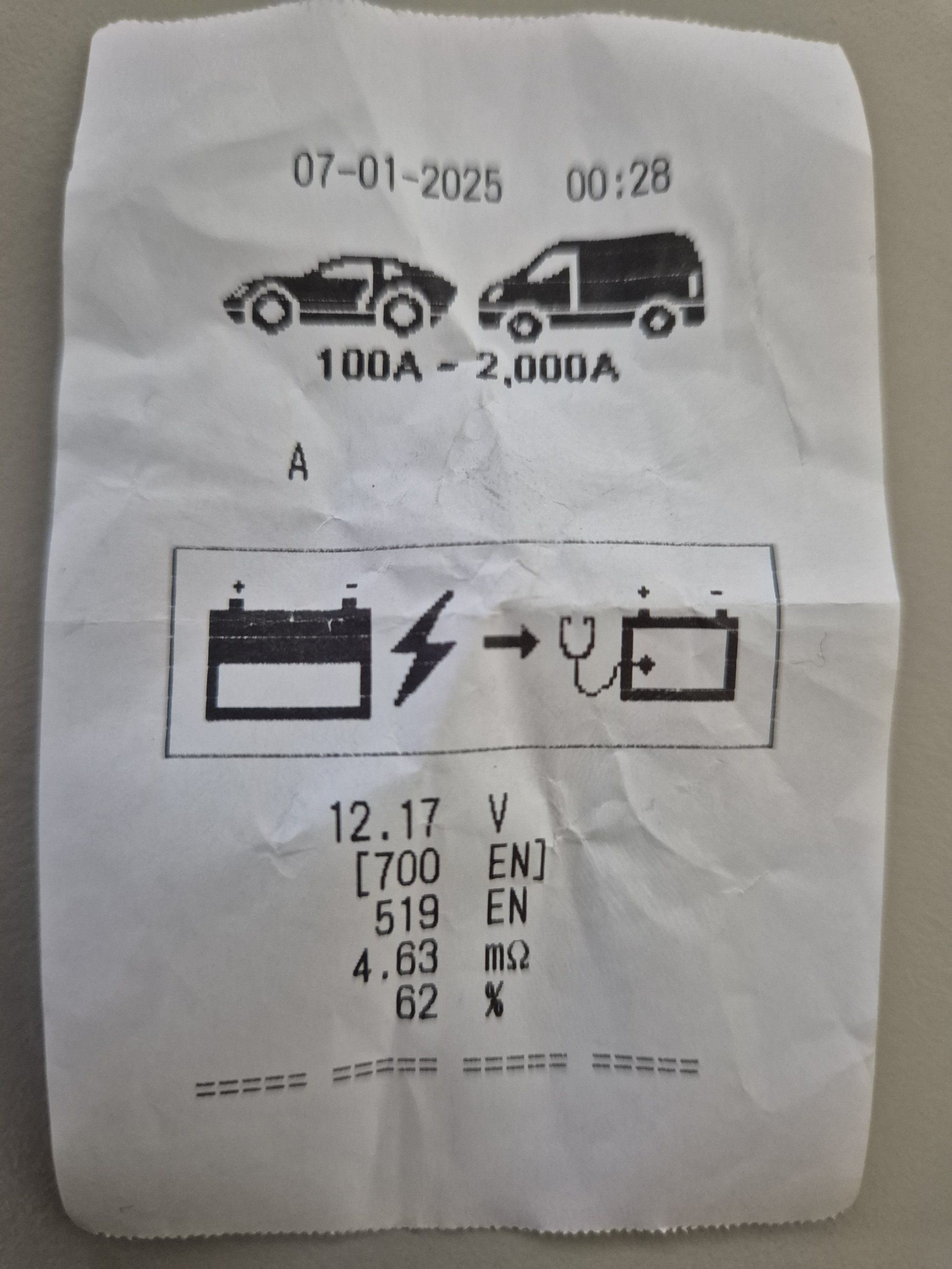

I decided to chase that idea and go to a shop nearby where they have a more proper battery diagnostic tool and it spits out this:
He said the battery is shot, probably the reason for all the failures.
Anyone have experience with this?
I'm calling my dealer tomorrow to get it replaced. It's covered by our consumer protective law which ensures me from things like this.
But still, I'm not 100% sure, if this is the root cause.. I might be a bit anxious when it comes to expensive things breaking down ? Then again, who isn't..
Battery "resting" voltage should be around 12.6V
Getting close to the 12V mark suggests it's almost fully discharged.
Modern car electronics hate under-volts and can display the symptoms your car is showing.
Yeap, I thought so also. I just sat in right now for a few minutes trying to set a few things up and the 12V battery warning showed up.
I'll get it replaced asap and post here after, to confirm if this resolved all my issues

Yesterday, I was at the SEAT dealer so that they could replace the battery. They changed it, and we went on a test drive. The errors were still there, and the oil was still swinging. All in all, the mission failed successfully. My head was spinning on the way home, not a really good experience with a car I was anticipating the most out of all I had.
