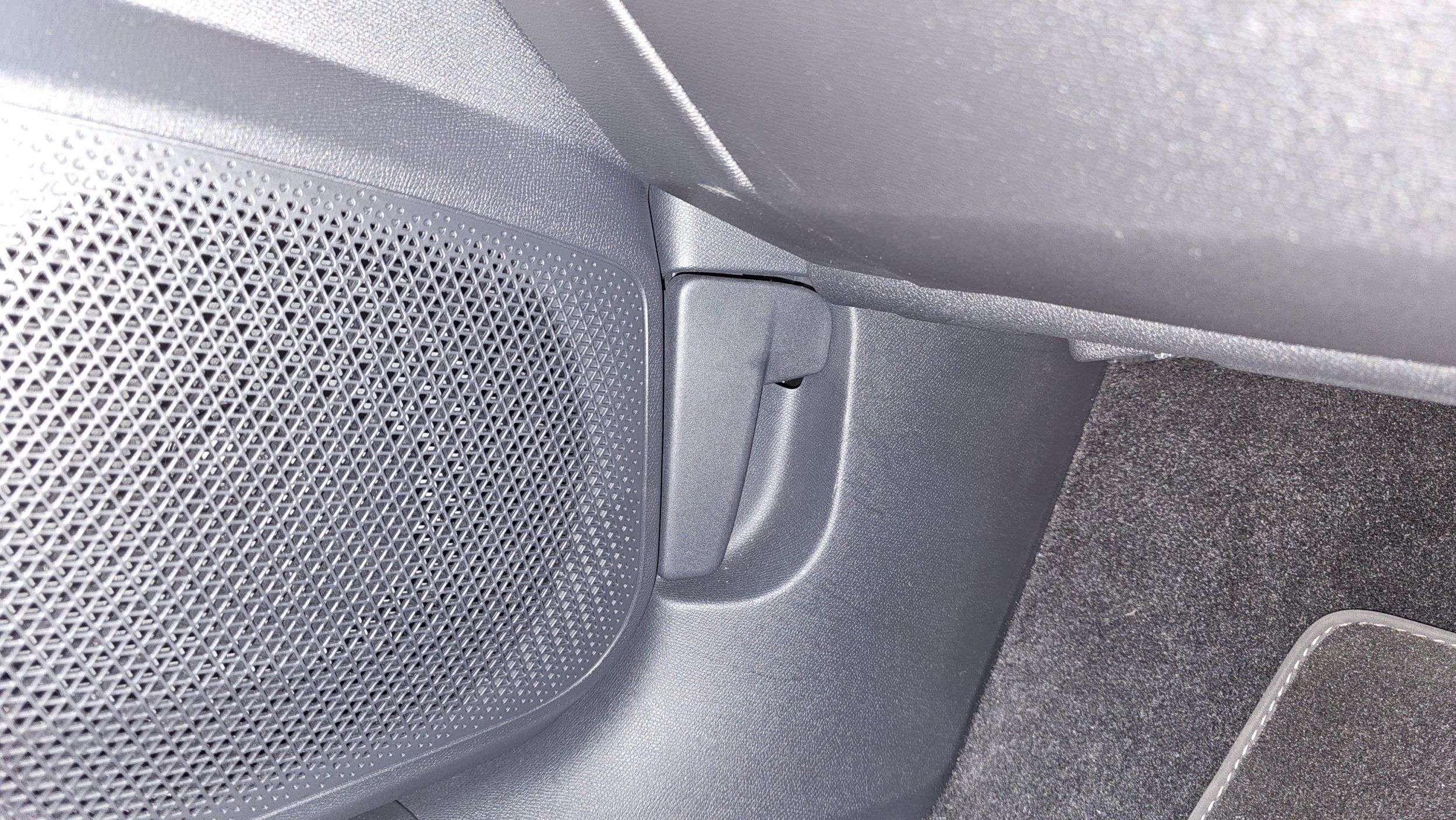

🤔 Is it possible to loop a cable tie or two, or packing tape or coat hanger and fashion a lasso or some such and loop over and pull the lever some?
Oh wait, I just looked at picture 😮
That's a complete 4 course dogs dinner of a design flaw 😳
Consequence of not enough thought for RHD, as with LHD you can open the door manually and thus the bonnet.

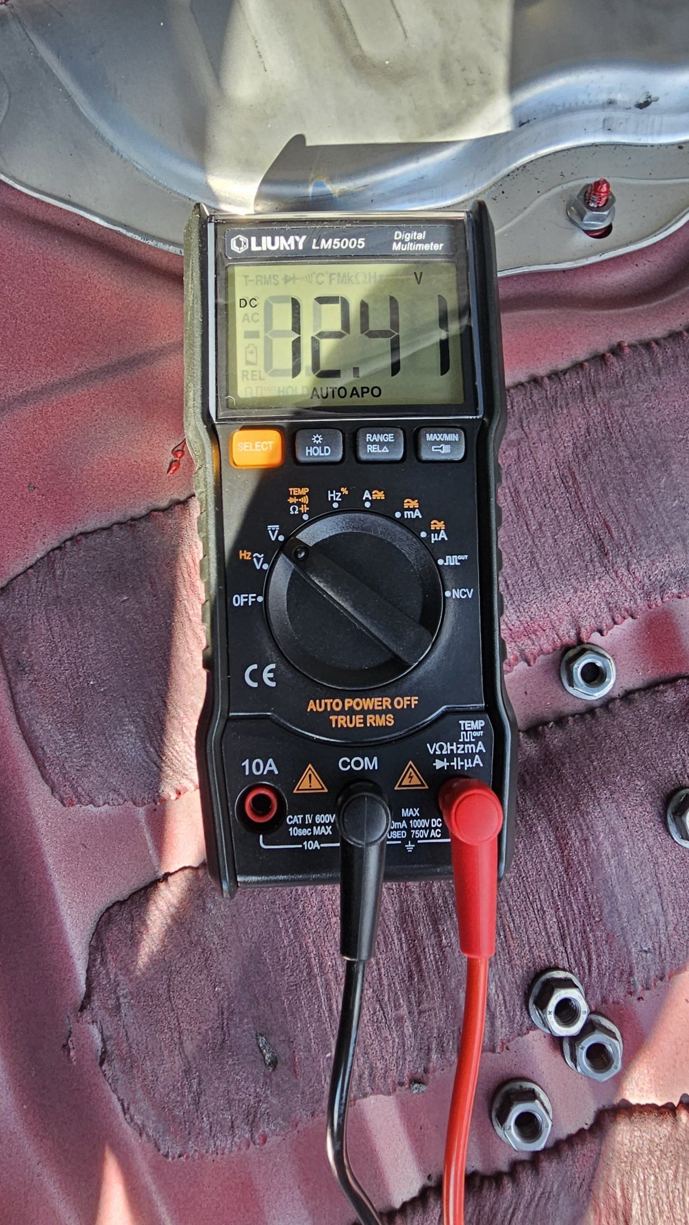

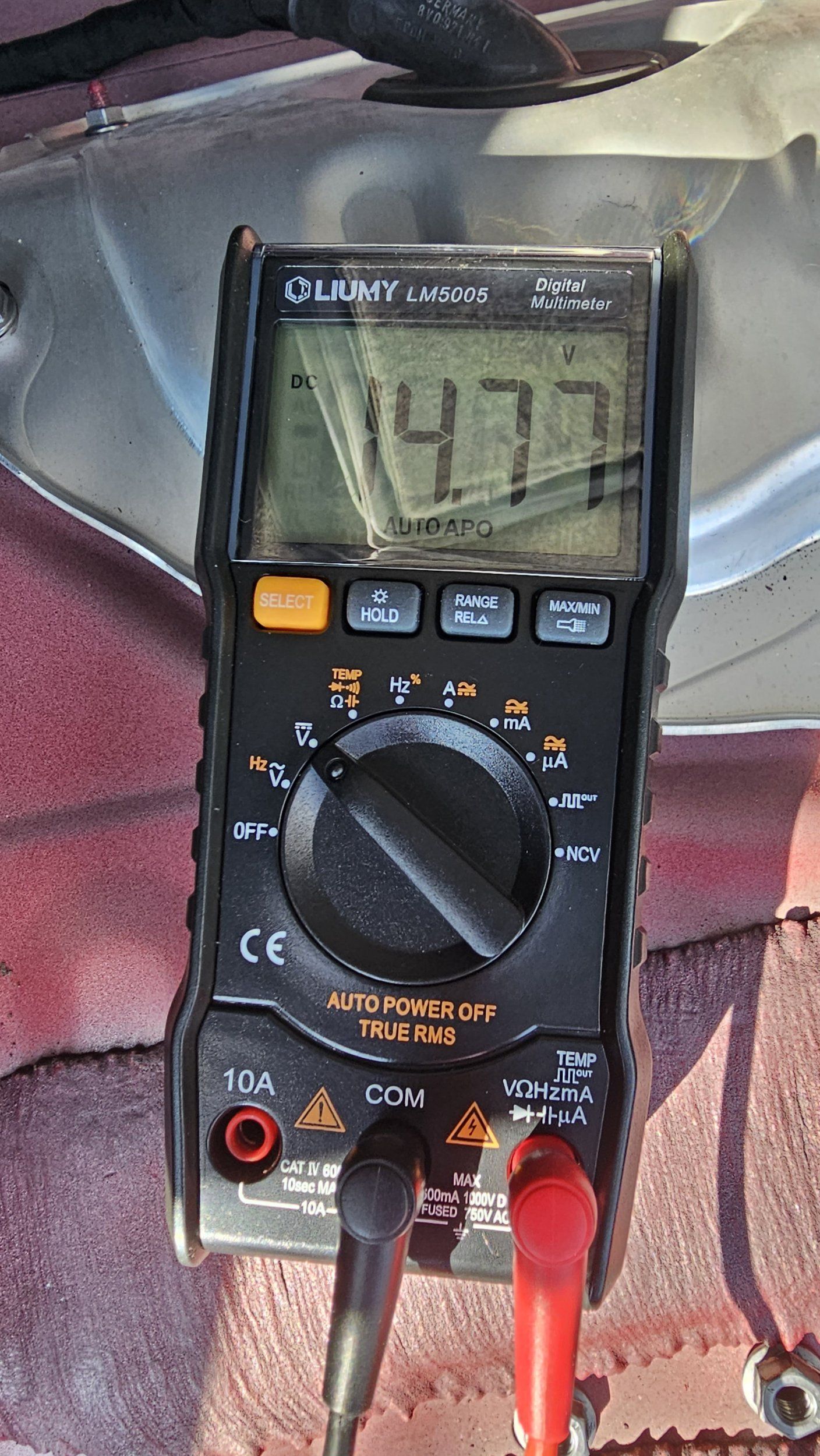

Looking good so far 12.4v with the car switched off. 14.7 with it running in EV mode (ICE not running)!

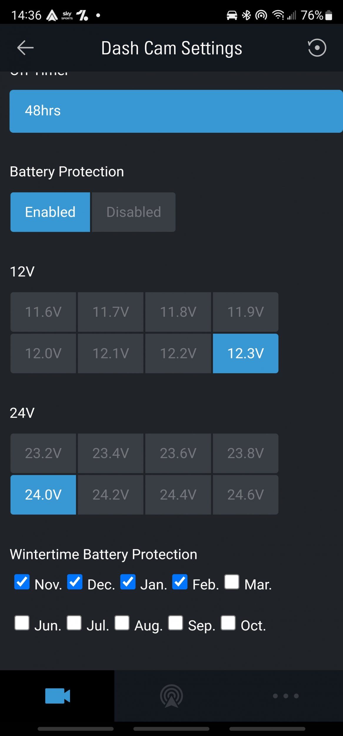

Do you have a Dashcam Dave?
Yes I do Wyldy. It's a Thinkware Q800 Pro, front and rear. It's set to shut down if the battery drops to 12.4v I think.
Thanks for reminding me though as I will check it. Iirc the lowest voltage you can set is 11.7v which is far too low imho.
Update: it's set to 12.3v which is the highest setting.
