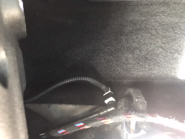

Hi Walone, I had a look at that post you talked about and spoke to Bubbs who was very helpful , but alas that’s not the problem because my rear washer tube is dry around the connectors next to the electrics in the passenger footwell so I’m back to square 1 and it’s not the battery.
Anyone else have any ideas . View attachment 15064

Bodger1
May 20, 2020
15
8
I was going to upload a picture but my phones not letting me
If you know someone with genuine VCDS get a scan done to see if it shows any fault codes, problem is that as the faults have been cleared they may not show again. Where are you based?
