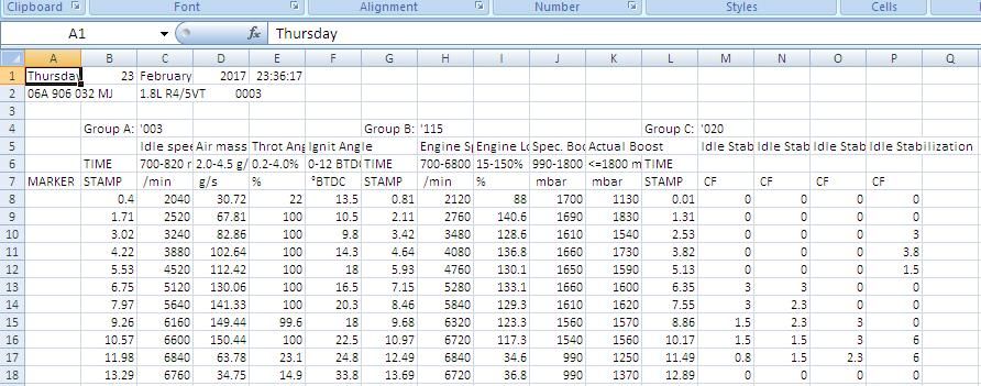

Below is the log I created earlier on my mates equipment...not sure if I have done it right, someone please point me in the right direction.
Started log on those 3 blocks, drove, third gear 3000rpm and red lined it.
Maf at idle shows 10g/s at 3000rpm
N249, N112 Bypass, SAI Delete.
Thanks all.

It's hard to tell from that log mate. Thats the right groups but maybe do a couple more runs and log from lower down the rpm say 2000rpm.
From the limited data it looks like boost is spiking up and the car is pulling the timing as it happens but hard to say.

Thanks Matty, so I'd be driving from point A to B, 2000rpm in third and redline it? And then from point B to A same again maybe?

Yeah that should be perfect. That way there's that bit longer to see how the turbo responds and what the car does with the timing.

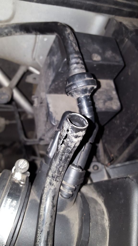

managed to find a leak from a split pipe from the inlet to brake servo pipe? done a temp repair on that.
Got a price of like £30 plus VAT from Stealers...if anyone has the part number, It'd be much appreciated.

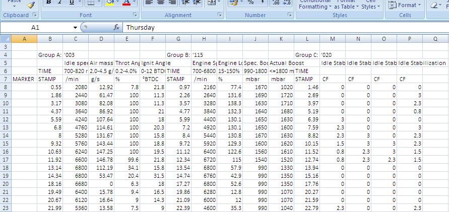

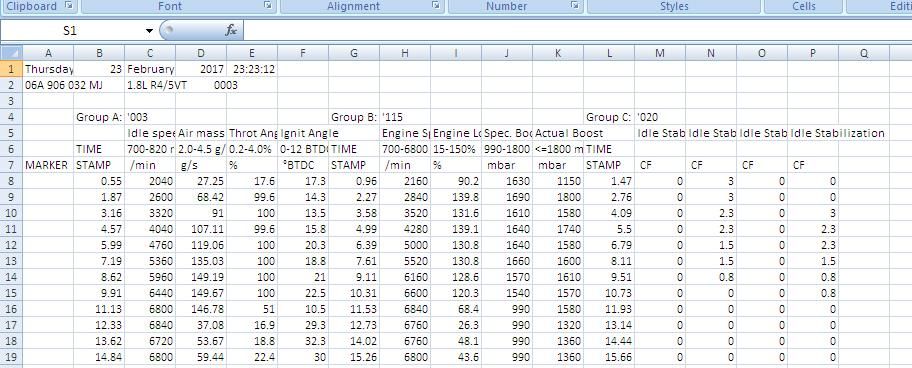

Then later on this evening I went for a drive and logged the car with Vag com again on 3 seperate runs, hopefully I have done it right...

Right mate, first of all i'm no expert, but a couple of things stand out to me.
The 1st thing is that there's no sign of it dumping and then boosting in your logs, boost seems to hold ok. The only thing that looks wrong boost wise is that when you are lifting off the throttle it seems to be taking ages to open the recirc valve. Maybe this is normal after the N249 bypass?, i've still got mine so i'm not sure.
Second thing is it looks to be pulling the timing quite a bit for fairly low boost. What fuel are you running it on?
As for the split in the vacuum hose to the servo, that would probably cause a rough idle so i'd replace that first and see what happens idle wise.

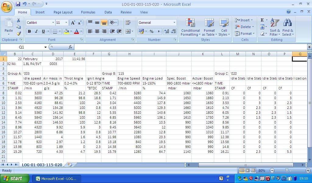

It can be run on standard fuel, but that's really only for pottering about in town if 'proper' fuel isn't available. Standard unleaded will knock at full boost and cause the ecu to pull timing or even drop boost.
It need's a minimum of 98 octane to run as a performance car, and there's only 2 fuels in the uk that meet that spec ....shell vpower and tesco 99 (which is hard to find)
Fill her with vpower next time and run some more logs. You should see a load of 0's in the last 4 columns of your logs rather than the 1.5's and 2's that you have at the moment.
