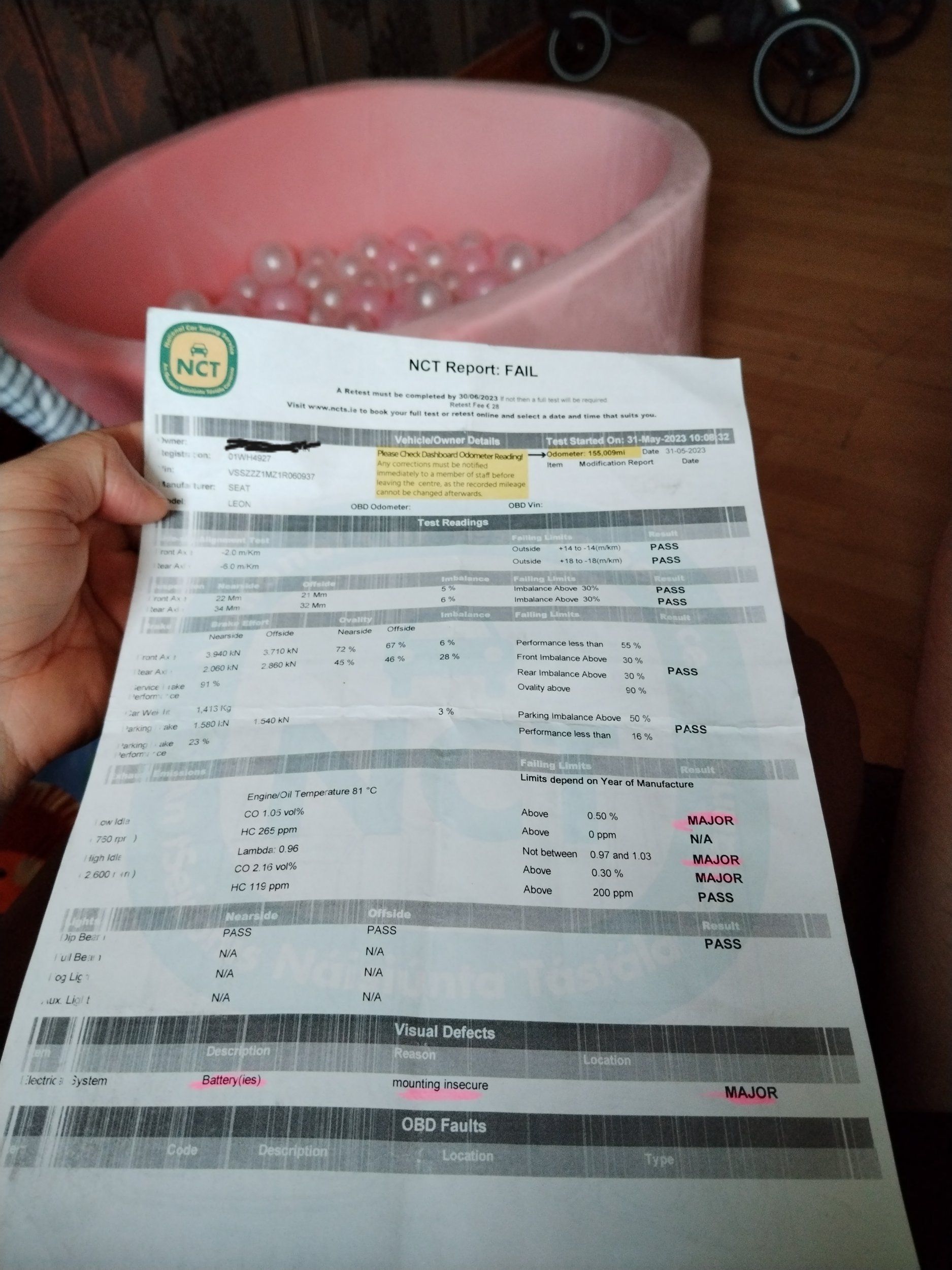

Mk1 Cupra Leon, 1.8T AUQ 180BHP mapped to 210, failed the NCT (Irish MOT) on emissions (couldn't be tested due to excessive smoke). Then some Wally decided to add an extra catalytic converter (obviously to try and mask the issue without addressing it) and put it through again. It failed again (but not due to excessive smoke this time, emissions were tested this time but the co was through the roof) (I will post a picture of fail sheet).
