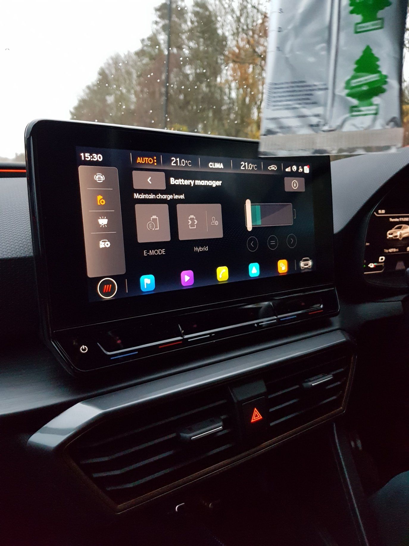

So this year my car went in for its service 1.4 Hybrid late October 2022 and it come away with a Recall update, a day later my infotainment shortly shut down and powered back up, thought ok that's not good i thought. However, a few days later it blanked out on my (at my local shopping area) and didn't start back up. It did allow me to drive back in Battery Mode to home.
The Next day i phoned Cupra up and asked what updates they have applied ,(under the recall) , they confirmed it was a 12v Battery Update i explained about the Issues since the service and that i had Hard Powered the Infotainment Down and back up (Pressed the Power for 25+Seconds) and it powered back up however the lead Technician explained it could be that when they applied the update that it didn't have a full reboot from cold so may have been that however they have booked me in for 2 weeks' time to be seen.
Today I've done a school run and its reverted back to the Battery again the Infotainment has gone all blank by the Power Management section and are totally greyed out it was perfectly fine before all these Sham Updates WHY WHY Cupra theres a Saying if it isn't Broke Don't Fix it! :mad:

I rember having a service recall for a control unit that sits on the negative terminal of the 12v battery. The dealer said that it can cause battery drain or misreading of actual capacity for the PHEV version of Leon so they changed it.

So since posting yesterday i went out this morning, done another Hard reboot and booted back up was dead still, turned off and back on and zoom its back to normal again for how long who knows. So Adrian so how long since they have replaced the control unit, also have you had any issues since please?
I made this post the day I got my car back (1st of October) and described some issues but it was just because of the software configuration that they forgot to do.
