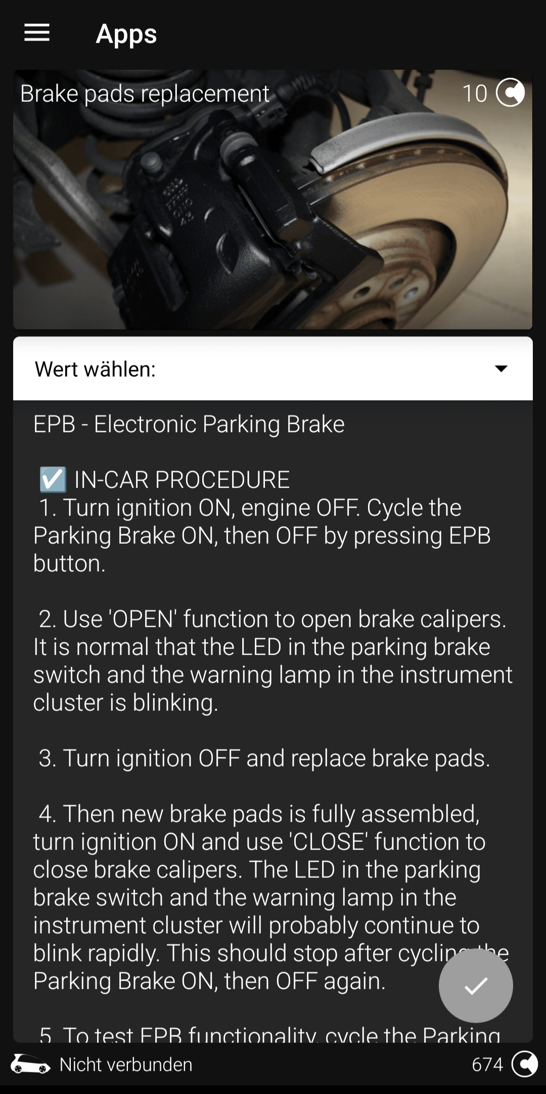

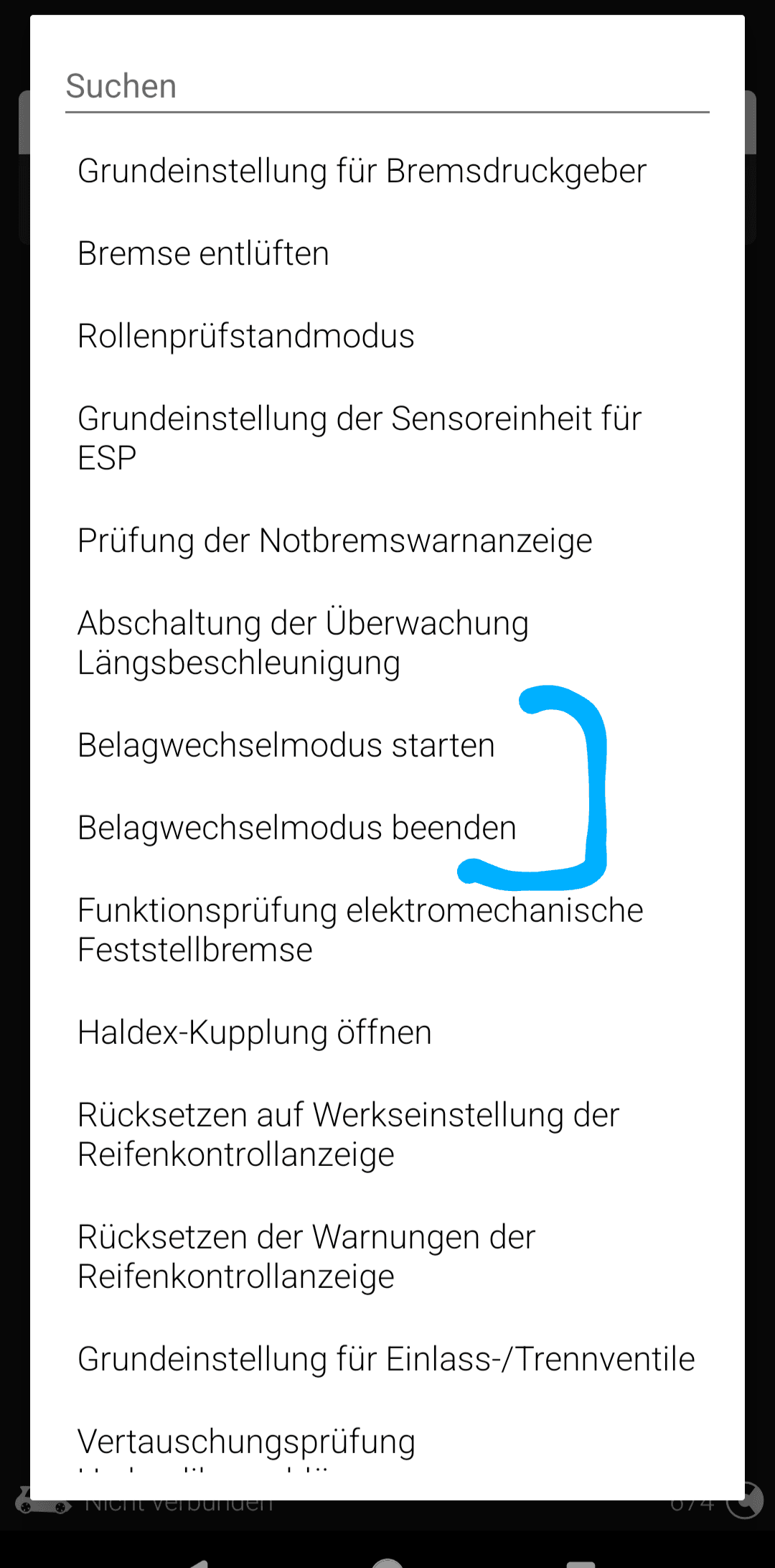

Of course, either manually or via app. But be careful, apps can also break a lot of things.
