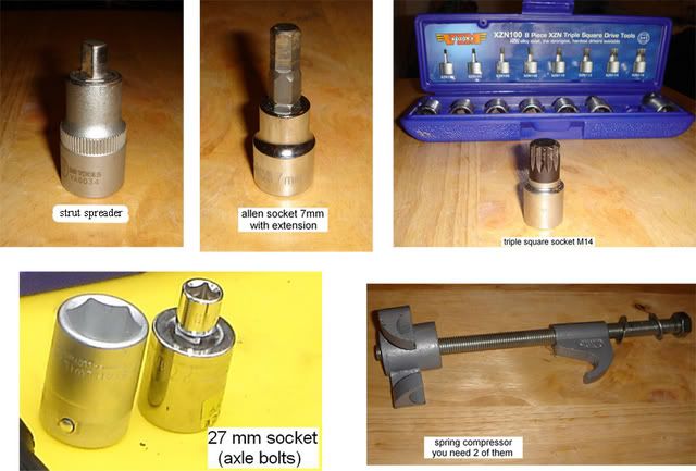

Sorry guys, should have been more specific, when i said which tools i meant as in sizes of spanners. I have changed suspension many times on different cars. Just unsure of sizes on the leon.
Front is a little more work. Just get a range of usual spanners/sockets. You will also need a splined socket & hub splitter to get the shocker off the hub.
I think you need two spring compressors, depends how heavy duty the one(s) you have are.
Trial and error, just look at the bolt/nut sizes etc and see which fits
