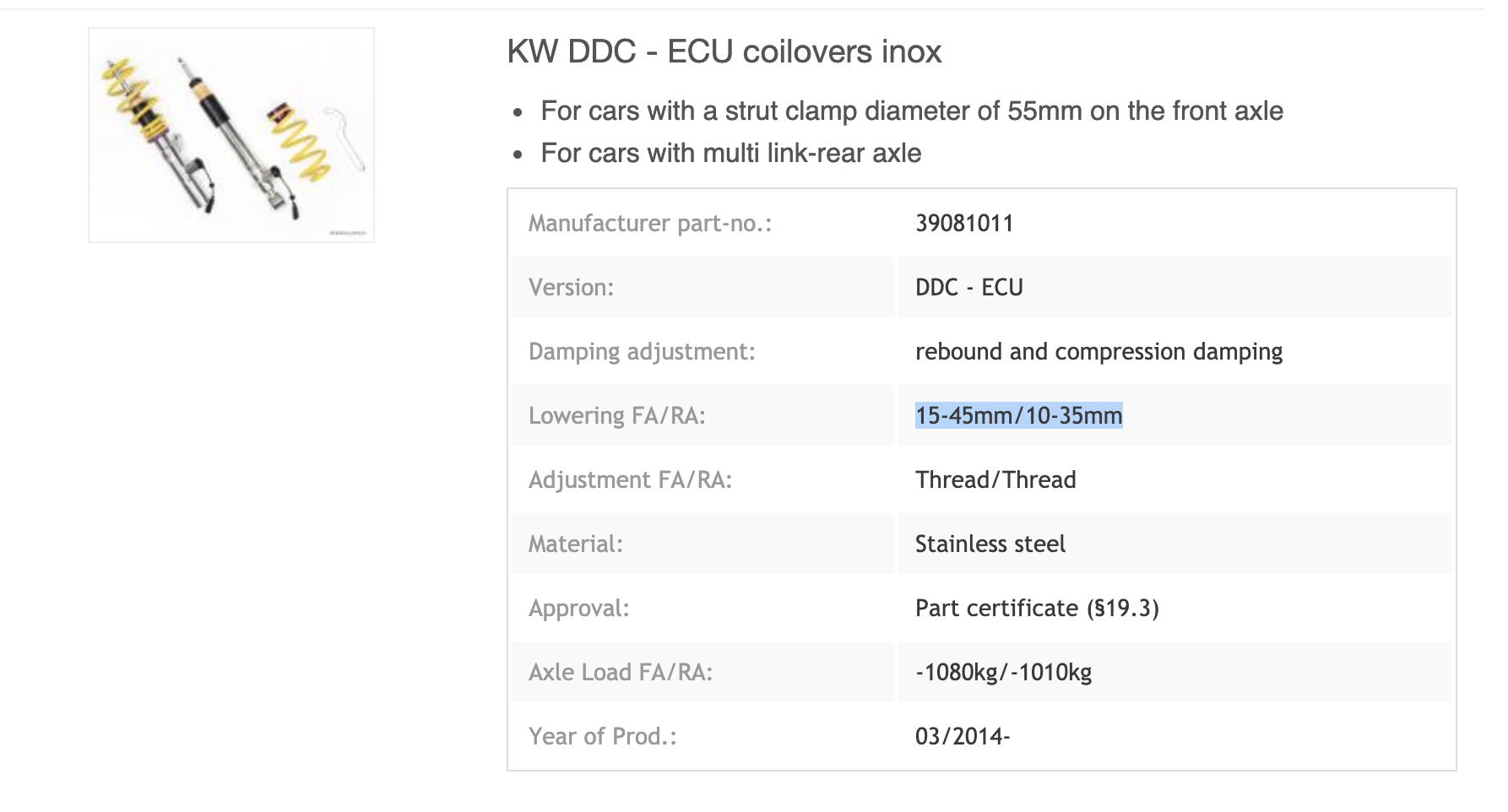

What does on a 45 offset mean?

It doesn't say that's how much it lowers when you put the suspension on, that is saying how much you can lower and raise the car once suspension is installed.

Yes it does chap, the lower of each set of numbers is the minimum the ride height will be lowered by fitting them. Therefore by fitting them the car will be lowered by 15mm at the front and 10mm at the back. The fact they are adjustable means you can increase this to a max of 45mm on the front and 35mm on the back. If you fit them you will not be able to adjust to the standard ride heightIt doesn't say that's how much it lowers when you put the suspension on, that is saying how much you can lower and raise the car once suspension is installed.
