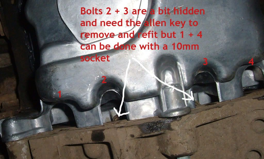

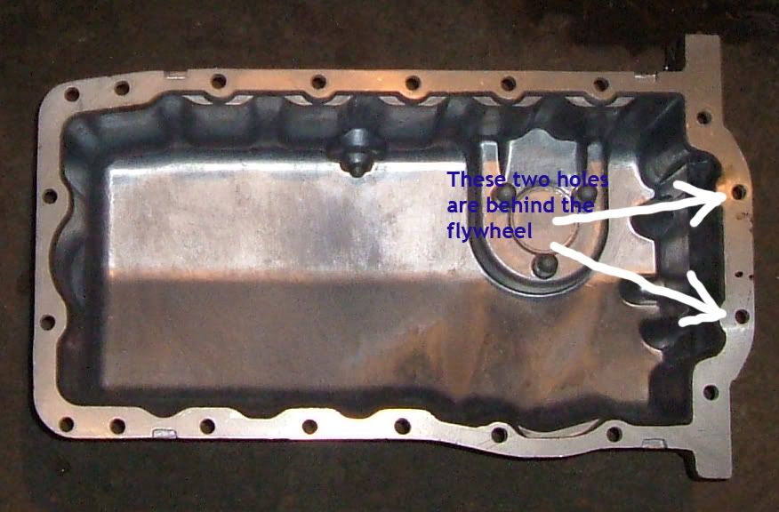

Well I'd get yourself one of these
and I expect they all have the same sort of bolt arrangement so look out for these hidden sods

As seatmann said 2 & 3 are abit fiddly and the one by aircon pump but an easy change. changed mine the weekend due destroying mine to having the car stupidly low.

But spot on about the two pain in the a*se bolts behind the flywheel ;)

Thanks for all the info Guys, job went without a hitch. Having the ball-ended alen key was essential so thank you for that tip.
Yeh it's handy, I think it can be done with a wobbly bar and 10mm socket but not 100% sure, I just always use the allen key instead. It's funny the only time that allen key gets used is if me or a mate whacks our sump lol.
