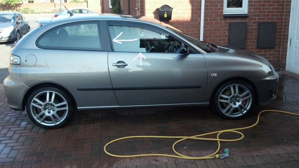

I think he means to place the cut rubber strips behind the rubber/cloth seals highlighted here
Half correct Pew
Arrow pointing to the left is correct, but other arrow is not, other strip needs to go along the top of the window.
Yeah you open your door (should of said that lol) and place the rubber strip behind the now exposed cloth seals (the material that has a nasty habiat of attracting alot of rubbish and tiny particles off say a micra fibre cloth)

So simply place the rubber strips behind the seal on the door pillar (arrow pointing left) and behind the seals along the top of the window frame (behind the wind deflectors)
Thats correct my friend and make sure you cut the rubber to fit the gap perfectly then pull the fabric back with say a pencil (thats what i used) and then just slide the rubber strip all the way across from one end to just past the side mirror. Then cut a seprate piece to run up the top section (vertically) as one strip wont bend around that tight right angle if you get what i mean ?

For the bit along the bottom of the window is the yellow or green gap best?
As phase has shown in his picture, it should go there and down behind the fabric vertically seen below his thumb in his first picture.
