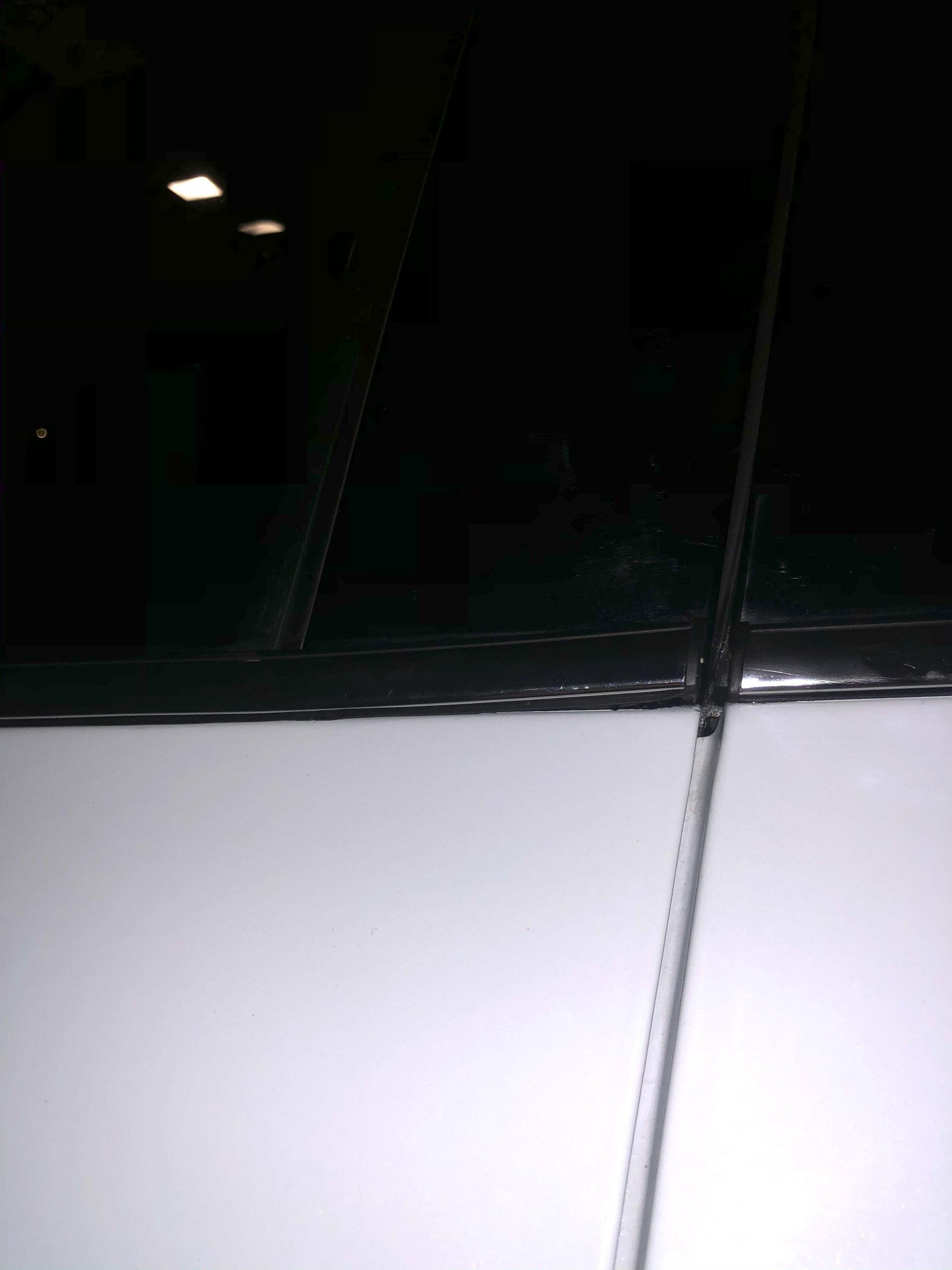

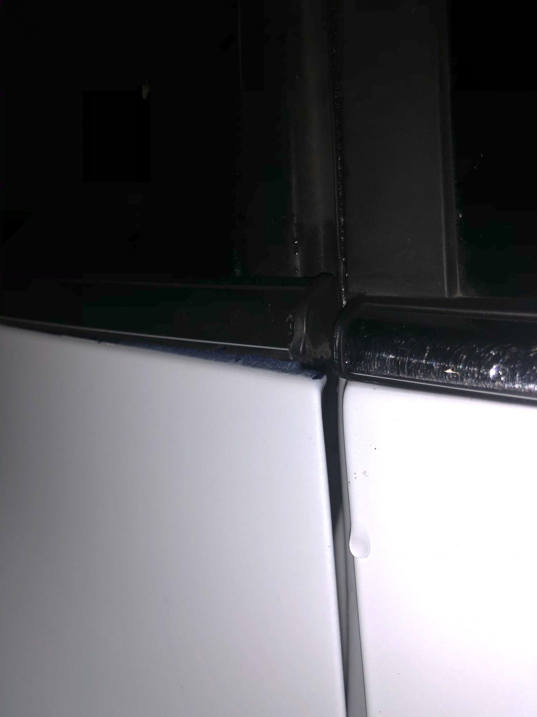

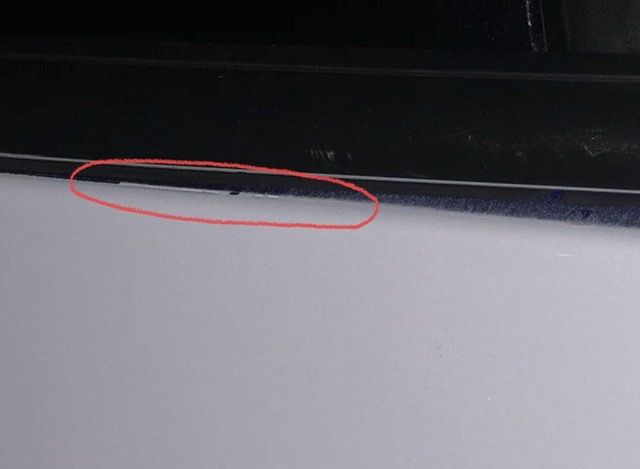

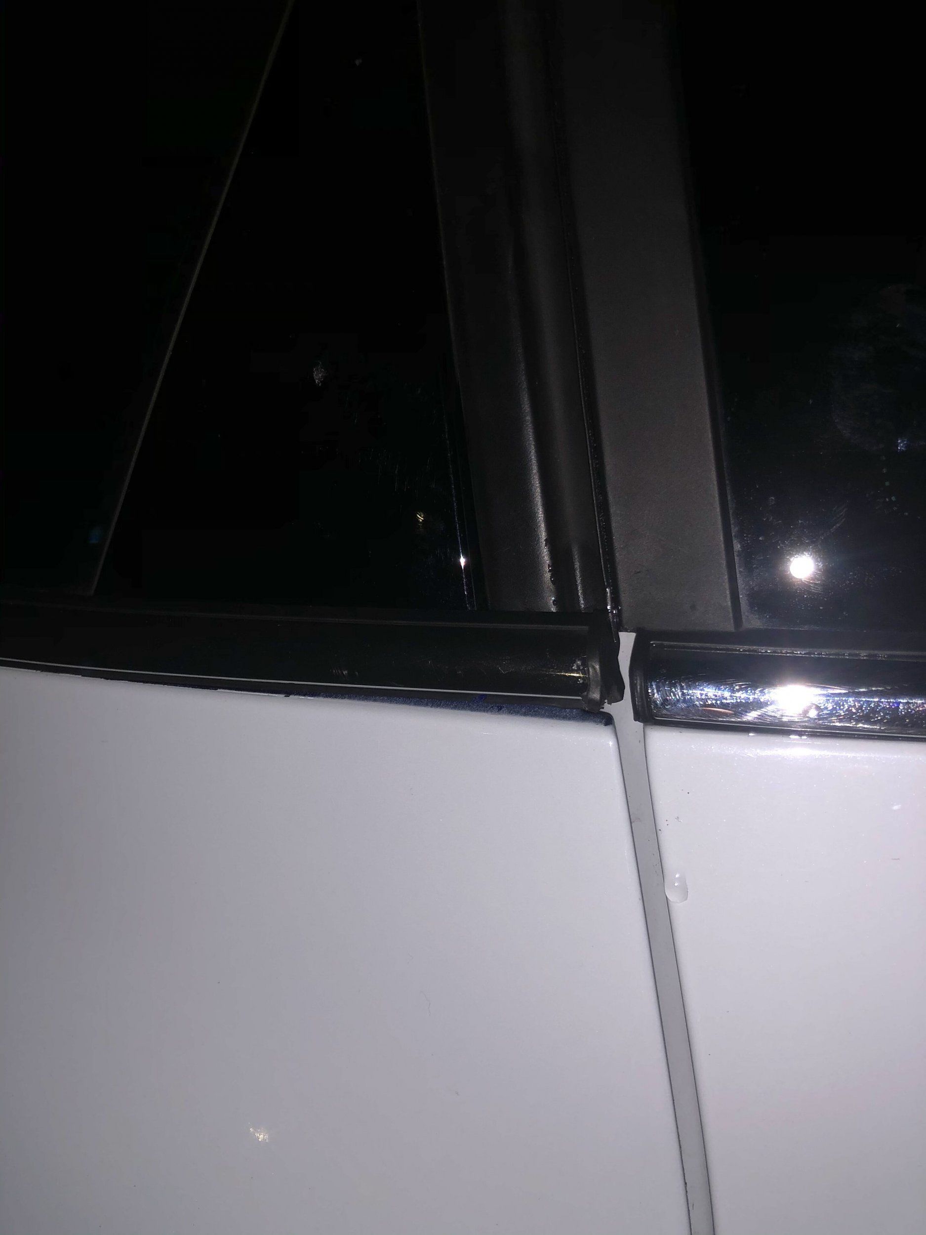

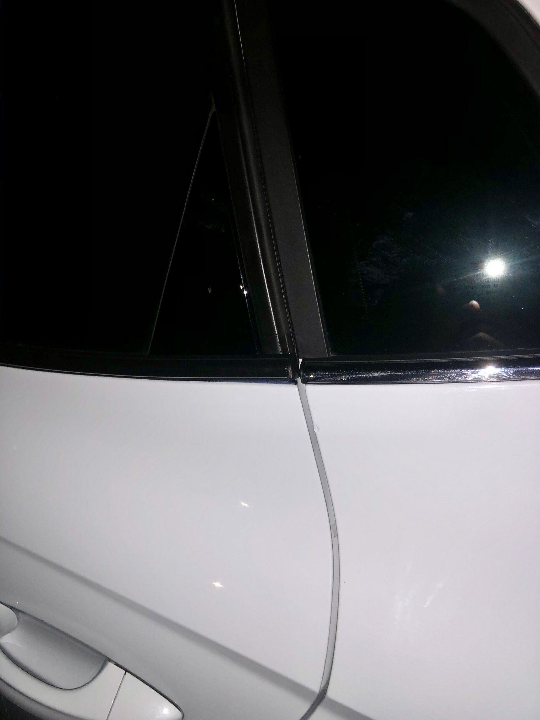

Hi guys
I recently bought an Ibiza Xcellence Lux DSG and I’m loving it so far.
I’ve unfortunately found a problem with the chrome trim around the rear window, it seems to be coming away and exposing blue paint underneath? No matter how hard I push it doesn’t want to stay down.
Seems to be a similar story for the front passenger side although much less noticeable there. See attached pics.
Has anyone else encountered this problem? If so, what did you do to fix it?
Cheers
SRGTD
May 26, 2014
2,704
1,551
From the pictures you’ve posted, your car is white so I wouldn’t expect the paintwork on the door under the window trims to be blue.
Did you buy the car new or used? If used, then blue paint under trim pieces on a white car may suggest repairs have been carried out, and second hand replacement doors from another (blue) car used for the repairs. If the original window trim pieces from your car have been retained and re-used, then the removal and refitting process might have distorted them - hence why they do not fit correctly.
I would be looking for other evidence of paint repairs; any differences in the shade or finish of the paintwork on the doors compared to adjacent panels, any other visible blue paint and / or ’hard’ edges from masking up areas of bodywork / trim to be protected from repainting. I’d also be checking door edges, door openings, behind door rubber seals and other parts of the bodywork near the doors for any evidence of paint overspray / rough paint finish. The areas I’ve marked on two of your pictures below look as if they might be hard paint edges as a result of masking up and painting. If you know someone with a paint thickness gauge, then it’d also be worth measuring the paint thickness on the nearside doors and comparing it to the paint thickness on other parts of the car.
Please update this discussion thread, once you‘ve had a chance to inspect the doors more closely and compare to the rest of the car.

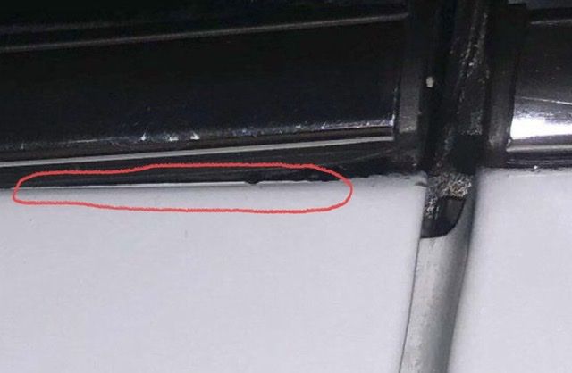

Sorry you've got an issue with your Ibiza :( It's always difficult to see from photos, but there also appears to be dust or debris under the paint here:

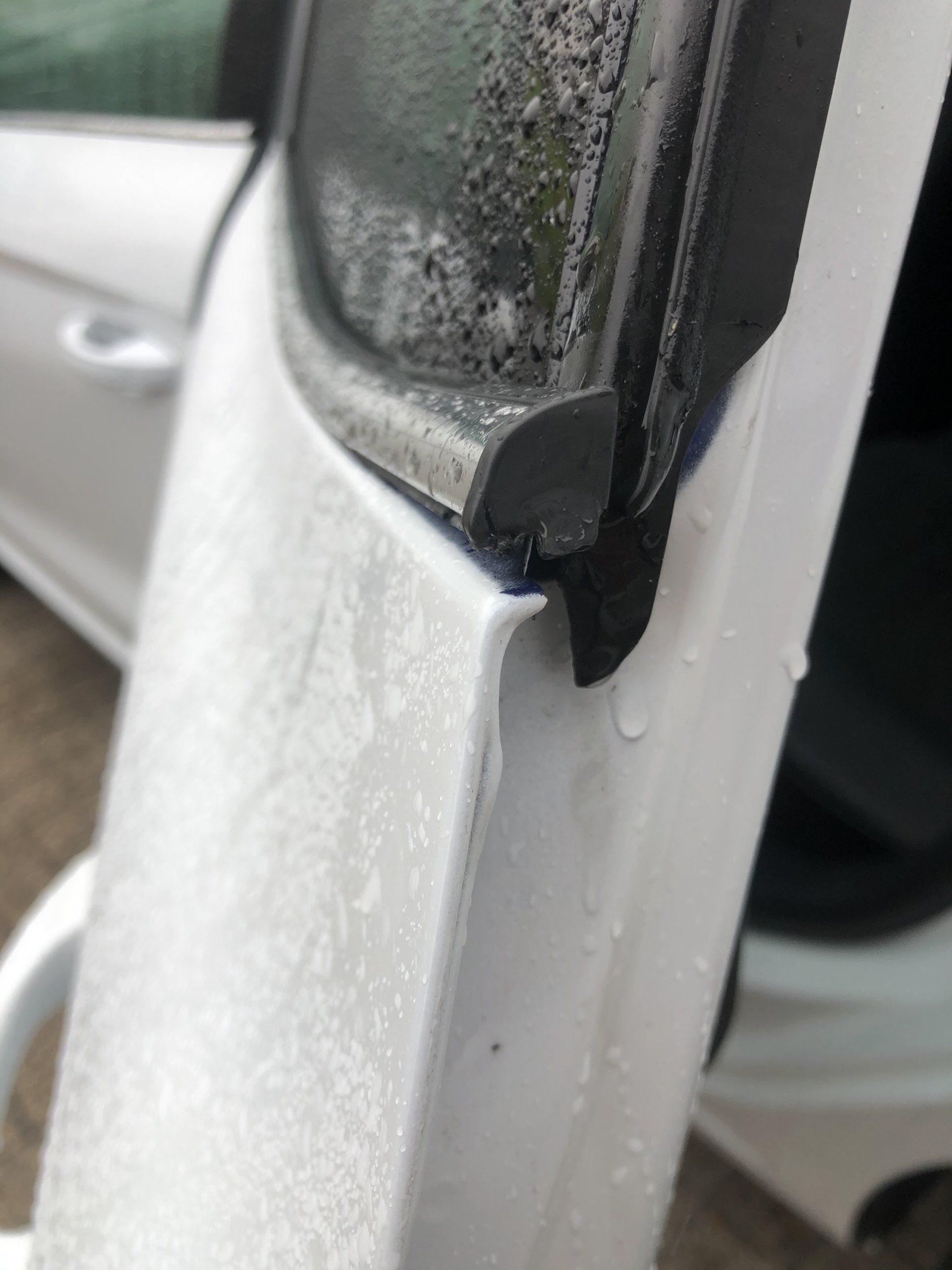

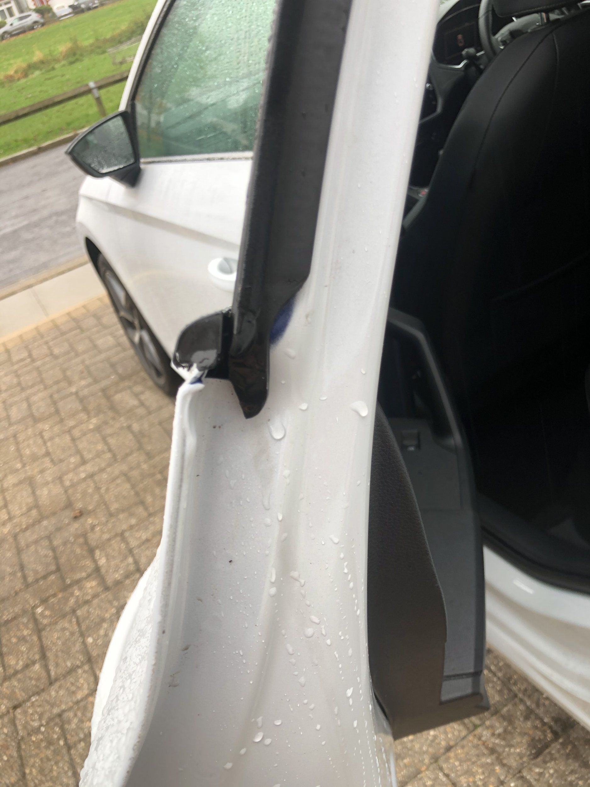

Thanks for your replies guys. On further inspection I can see more blue paint on the inside of the door. It also seems the seal has been damaged - see pics. I bought the car used a couple of weeks ago from a dealership, of course not noticing these issues when I inspected the vehicle beforehand. In terms of paint, the colours on the doors match elsewhere perfectly, and the hard edges you speak about are only noticeable as the trim has lifted up.
It goes without saying that I’m a little disappointed, although I probably would’ve never noticed it had the trim been in its original shape. Would this be something a dealership should inform the buyer of beforehand? Would I have any form of recourse in terms of getting them to pay for it to be repaired properly?

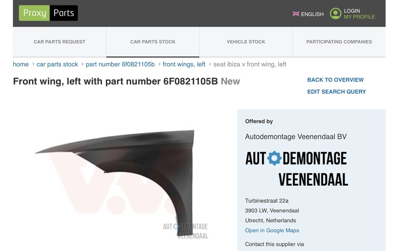

I don’t think the Seat service advisor is correct regarding a blue coloured primer being used in the factory. Below is a link to a YouTube video of a Leon body shell going through the painting process on the factory production line. The primer used is a very light grey (almost white) colour - seen on the bonnet of the car at 3min 44sec to 3min 55sec and again at 4m 32sec. The light grey primer isn’t just used on the Leon - it’ll be used on all Seat models. I think the light grey primer is used across all VW / Audi group brands - all of the VW’s I’ve owned have had light grey primer (visible when the car’s picked up stone chips) irrespective of the paint colour of the car.
Genuine new OEM Seat replacement body panels used by body shops to repair damaged vehicles have a satin black finish - not blue - and the body shop will apply a light grey primer coat before the body colour paint is applied. Here’s a genuine OEM replacement front nearside wing panel for the Ibiza before it’s painted - the part number listed (6F0821105B) is correct for the genuine OEM part being sold.
