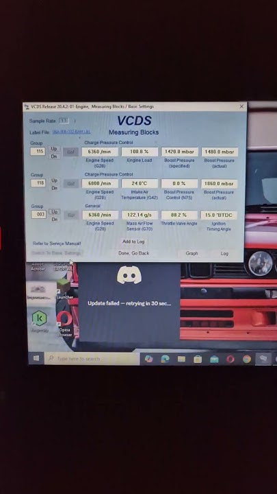

You were completely right about the EGT causing limp mode. On my first pull, it triggered limp mode, and when I checked the codes, there it was—the EGT-related fault.
I’ll see if it's possible to reinstall the EGT sensor, but if not, is there a software way to remove it properly, or would it be better to get a new housing and rebuild the turbo again?
Also, if anyone knows a good tuner who can handle this properly, let me know.
On top of that, I’ll be fixing the intake hose to stop the unmetered air from entering the turbo, which should help improve performance.
Here’s a log file with the MAF plugged in.
  • LCR LOG-MAF.zip

Looking at your logs, the air/fuel mixture is going crazy rich under acceleration. If you look at columns J and K in your logs, you can see lambda requested vs the actual lambda. Because the ECU is seeing high EGTs, it's making the mixture richer and richer, trying hard to bring the temps back down. (HIgh EGTs are usually the result of a lean mixture)
Nomally you'd expect to see lambda in the high 0.7 range under wide open throttle, but your requested lambda is going way into the 6's. In fact it goes so rich that it seems your the lambda sensor maxes out and get pinned @0.750001. That's probably when the ECU sets the fault code. With a mixture that rich you aren't going to blow the engine up, but you will probably get misfires and possibly start fouling the spark plugs etc too.
Someone with the right tools and knowledge could probably map the EGT out, but I wouldn't recomend it. You may get away with it depending on the tune, but it would be far better to have it fitted if possible.
A machine shop maybe able to tap a hole for it to fit in your new turbo, but obviously it depends on the design and difficulty of doing it. You'd have to speak to a specialist turbo place really, see what they think. They may have dealt with similar issues before
