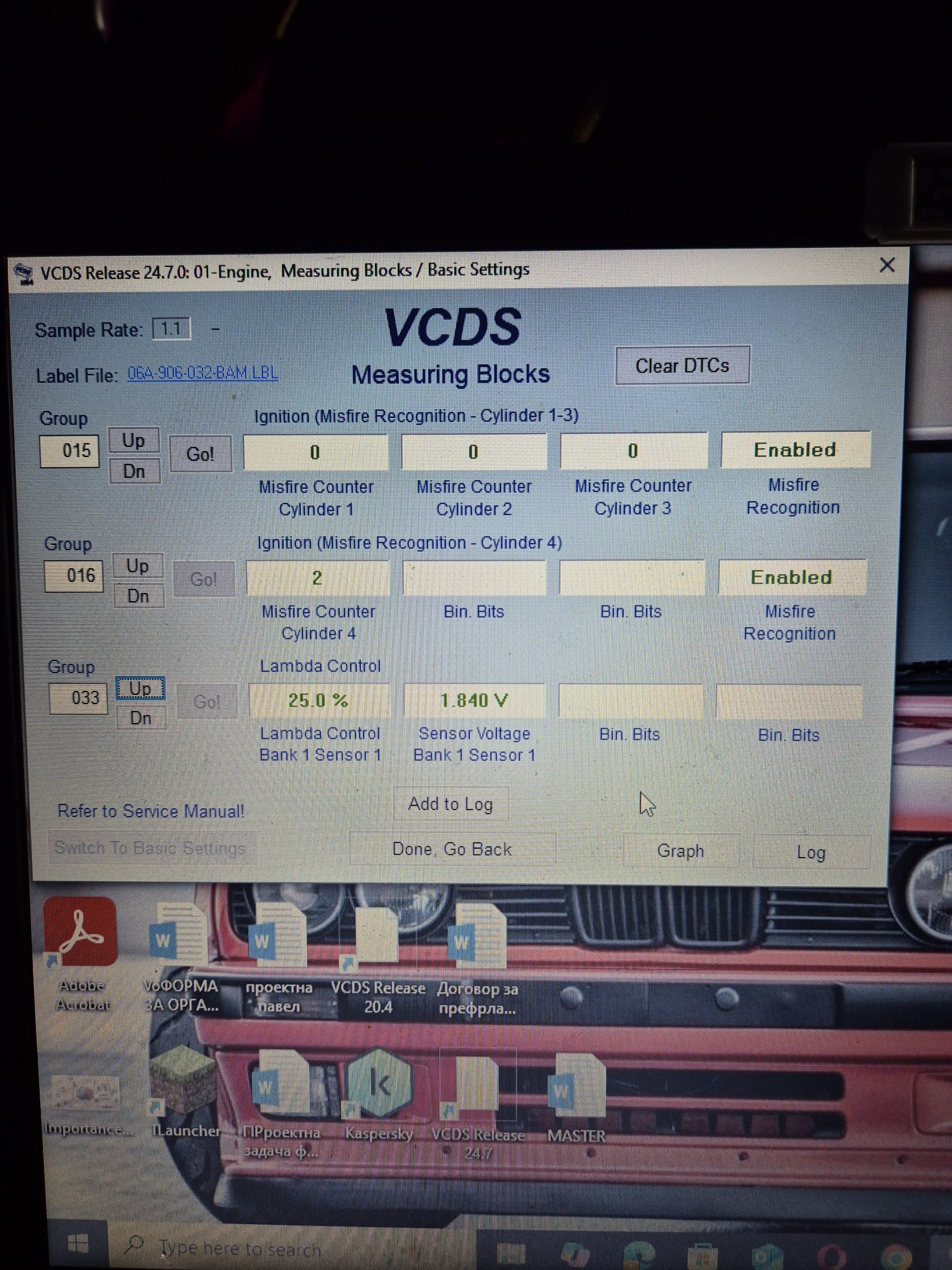

I have misfires on cylinders 1 and 2, mostly on cylinder 2.
When I clear the fault codes, the Lambda Control Bank 1 Sensor 1 (block 033) shows 25%, while block 032 (Adaptation Idle) is 0%, and (Partial) is also 0%. During this time, the misfire occurs.
After idling for a couple of minutes, the misfire stops, and block 033 fluctuates between -1.6% and 4.7%, while block 032 (Idle) remains constant at 5.3%, and (Partial) stays constant at 10.9%.

25% means that it tries to correct in a very big way, thats not good.
Could very well be false air. Too much unexpected air, then tries to adjust fueling. Swap 1 of the injectors (cilinder 1 or 2) to cilinder 3/4 and see what happens
Could it be that the system is trying to correct the air-fuel ratio (AFR) because the mass airflow sensor (MAF) is reading about 3 g/s at idle? If the inlet hose has a crack near the turbo or after the MAF, wouldn't the O₂ sensor detect it and signal the ECM to add more fuel?
