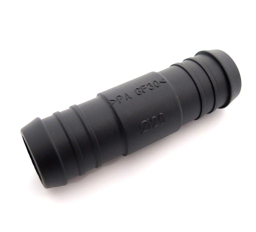

Because i can't find the PCV hose, can i do it with 2 hose connectors and silicone hose?

This is how it looks. The hockey puck is not on this picture
Information for simplification: https://www.uk-mkivs.net/threads/1-8t-pcv-simplification-and-catch-can-installation.17685/

that hose is available on amazon or ebay, its a common part.

Yeah the hose is available on amazon or ebay, but in Macedonia is almost impossible to get it shipped.
