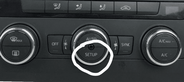

If you press the setup button circled below - you can change how strongly it tries to achieve the desired temperature. Try changing it - and see if that improves the cooling?
Additionally, Your AC system is not hermetically sealed like a fridge. The refrigerant can slowly leak out - at a certain point reducing its cooling ability.
If it's never had a regas at 6 years old, I would check for fault codes and give it an AC regas.
