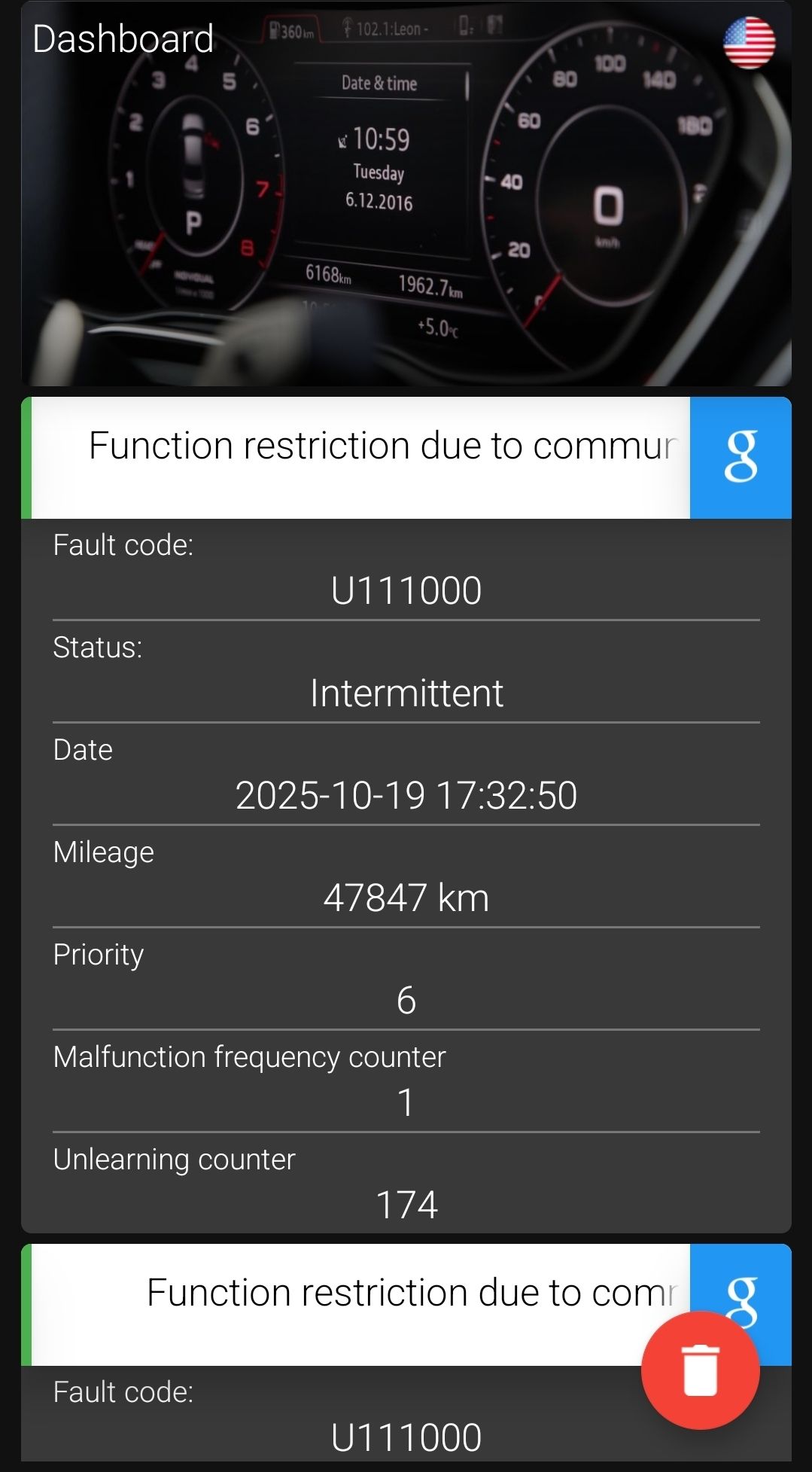

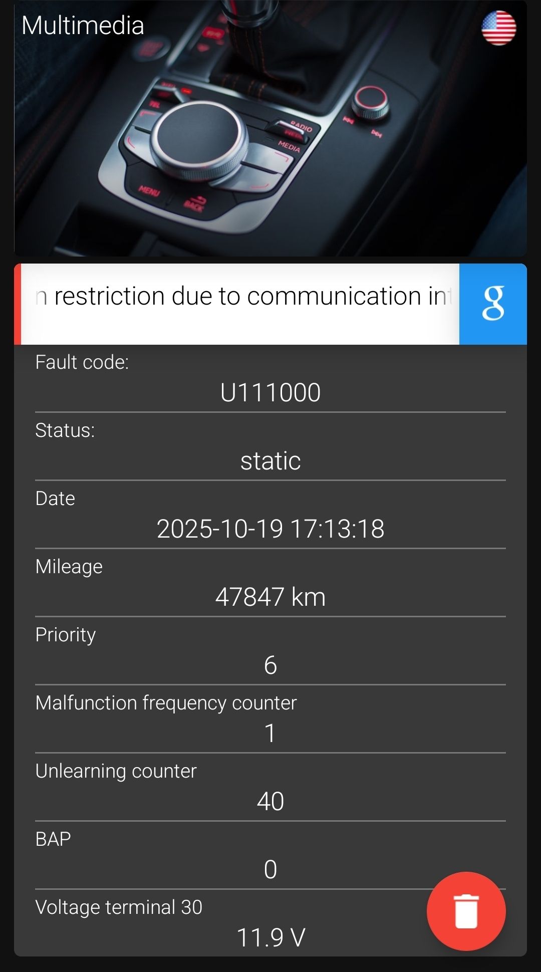

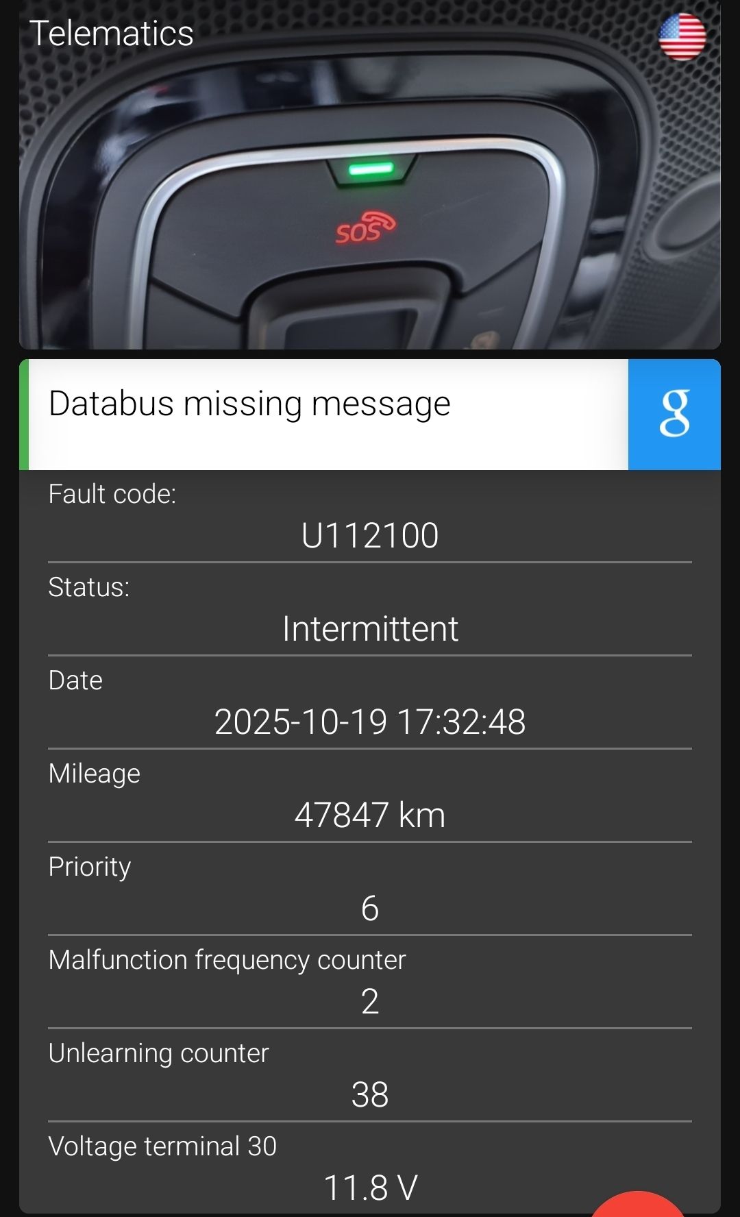

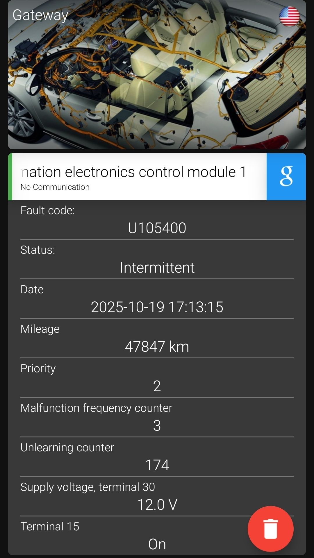

I'll attach screenshots of the (persisten) fault codes. They seem to indicate what you've suggested, but in all honesty I have no clue how to fix them.
