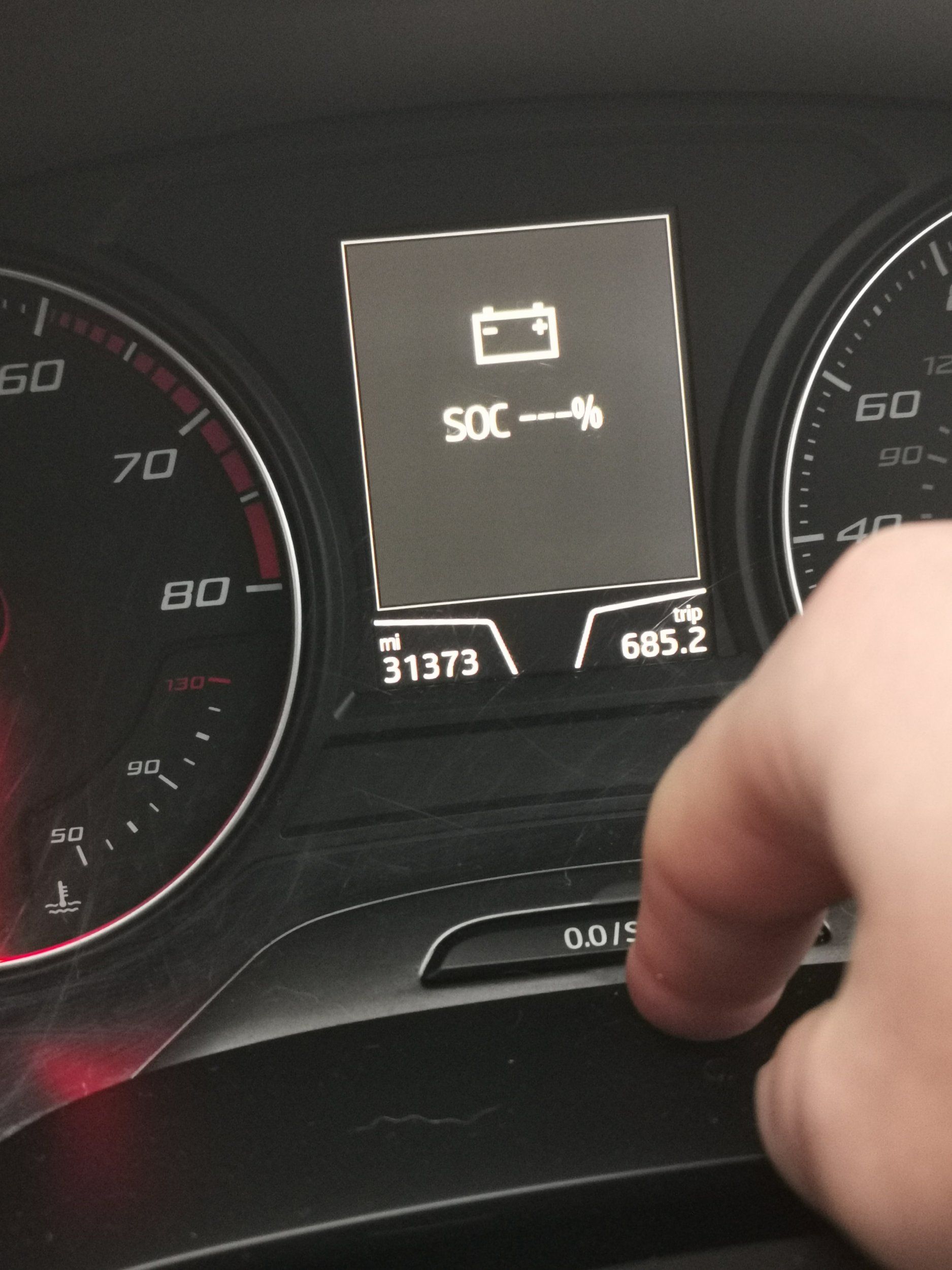

Hi thank you for your response, I did think maybe battery from the get go! I tried what you said a few times and got this message

Ok, the SOC is not the most reliable, but the fact that you are getting — % reading is indicative that this may be a place to start the fault diagnosis.
Due to the stop/start system and electronic control modules these vehicles are very sensitive to battery type / battery control module issues. ie. If the battery is replaced it has to be coded to the vehicle for example.

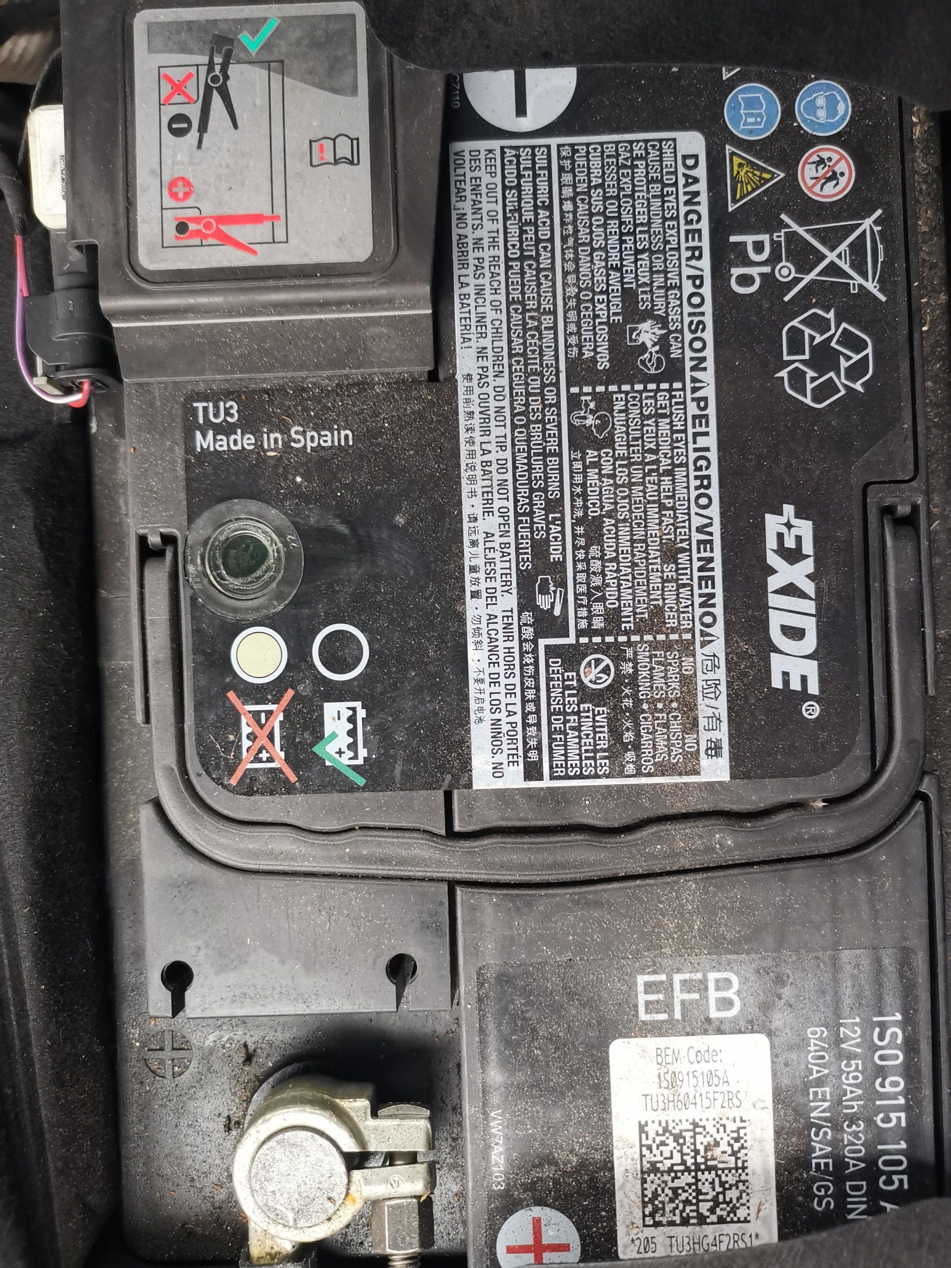

This is the battery so the indicator seems all good:

Your battery looks like the OEM one fitted from new - unless it’s been swapped via a donor vehicle.

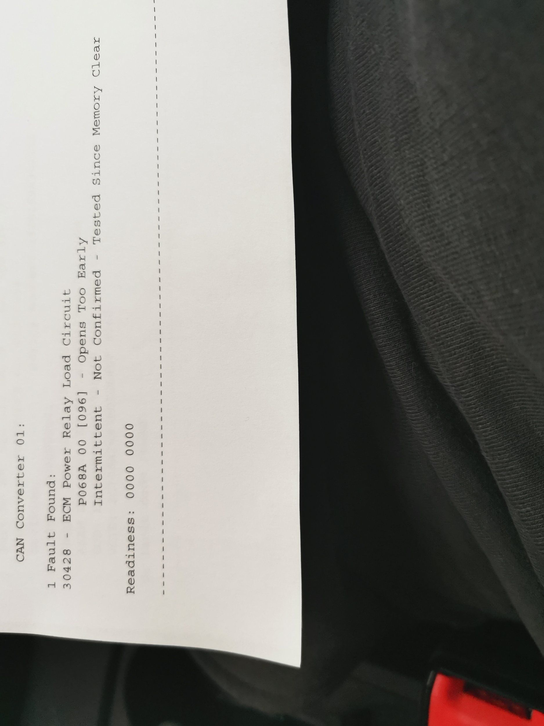

Some info on the first fault here:

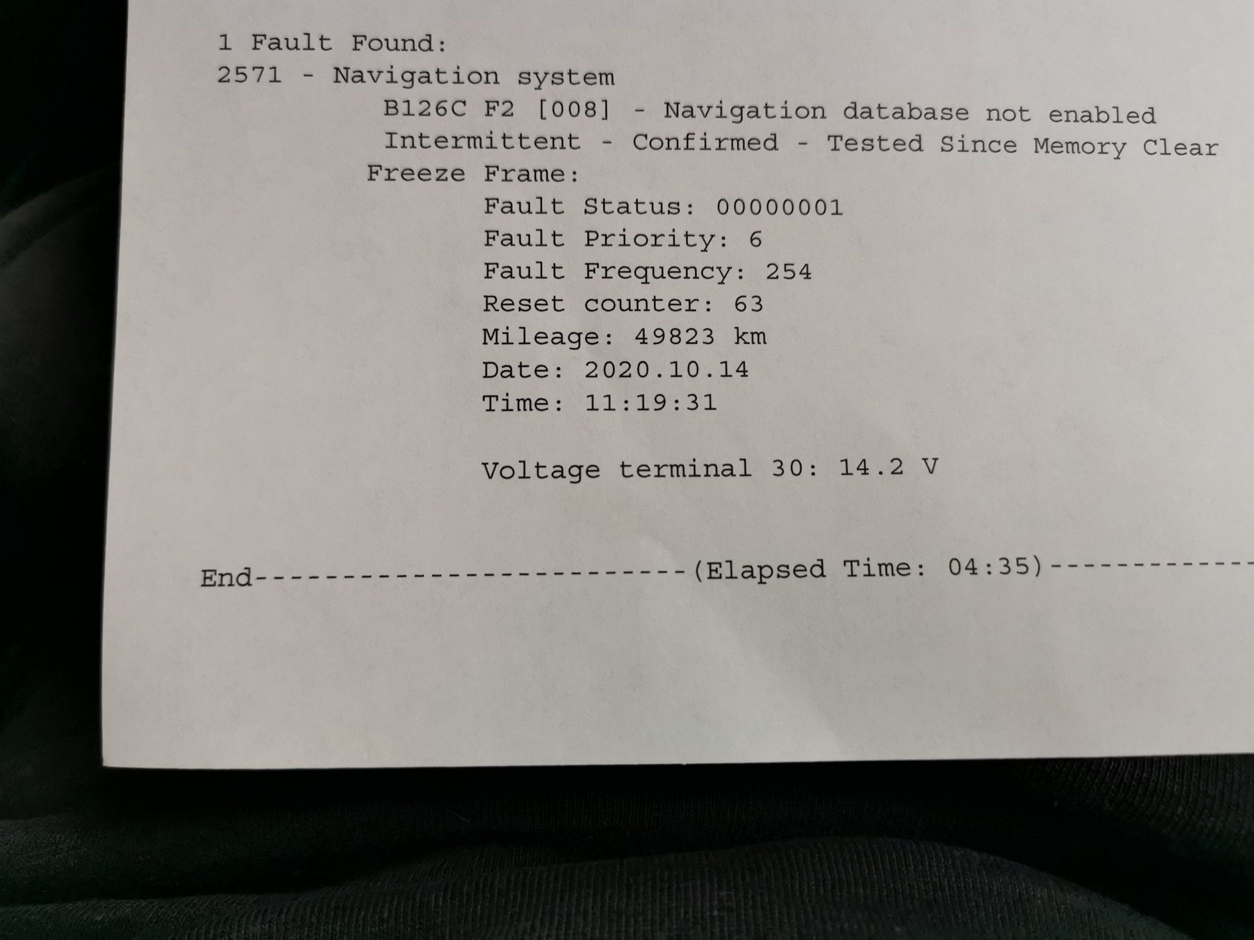

I believe (don't quote me) battery was at 14.something volts, the guy said it was a normal level on print out but garage have it now so can't check!
But they just dismissed that fault code, said its nothing to do with that problem and that it's engine related relay! I dont know what they're plan is but I will keep you posted.
Edit:
Says above in image 14.2volts
