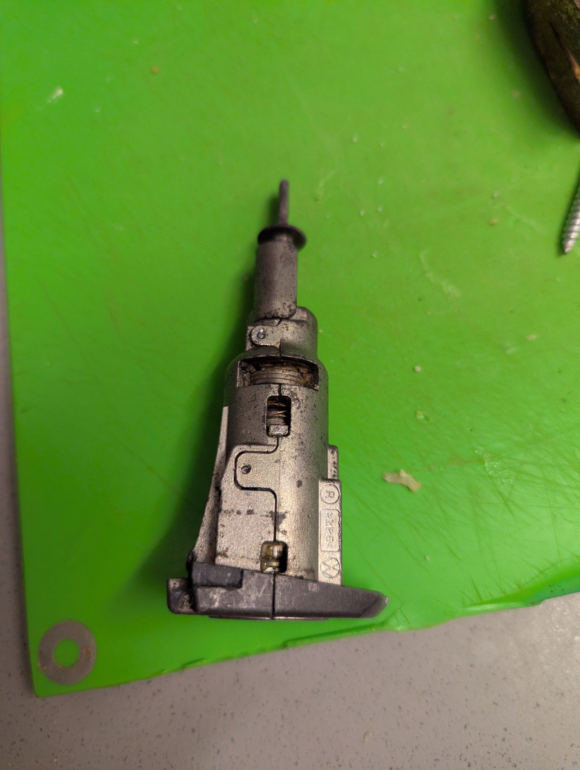

Little update. Auto lock smith came out today and re coded the key but it still won't work. Scan the car and no faults. He thinking it's a broken paddle in the door lock barrel. I have taken it out and you can buy replacement parts for it but mot sure how you get in to it as it seems sealed.there are 2 pins but they don't come out.
How do you order a new one that works with your key?
How do you order a new one that works with your key? View attachment 51329
Well I got it apart but I now know it's not supposed to come apart.
Struggling to find a replacement online. Anyone any ideas?
